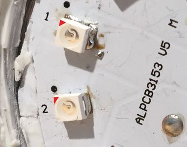

Step 3: Solder Your IR LEDs in Place
With the board prepared, you're now ready to move on two last items and finally soldering the LEDs. The steps below will help ensure a strong reliable solder connection - saving you from coming back to fix it later.
- The first item will be ensuring the pads you prepared in the previous step have good clean solder on them. This means removing excess solder or applying additional solder where necessary. A good pad should have a very slight dome on it - one rule of thumb here is that it's very easy to apply too much solder and in fact more difficult to get it right. In this case, the lower the dome's slope the better.
- The second item will be to apply flux to your prepared pads. If you do not have flux I would recommend buying it. I have previously purchased this flux and found it useful for this project because it has a precise applicator. A light coat of flux will suffice - again, in this application you want to apply the thinnest film of flux you can.
Now that the pads are cleaned and fluxed you can proceed to place your LEDs and solder them to the board. In order to align the IR LEDs I used curved needle nose tweezers, like these. Be sure to align the corner-indicator with the dot on the circuit board.
With the IR LED aligned take your soldering iron and apply the smallest dab of solder you can catch. Apply the small dab of solder on the tip of your iron to the metal frame of the IR LED's pad. The flux you applied above will help draw the solder into the joint.
You will know if you're applying too much solder because your joint will look like the connection in my photo. A good joint should look clean and shiny. If you see yellow or brown marks around your solder joint it is just left over flux - this can be cleaned later with 90% or more Isopropyl Alcohol.
Repeat these steps for each of the IR LEDs on your bulb.
