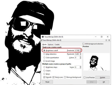

Step 3: How to Vectorize an Image in Inkscape
Now you will learn how to vectorize an image in Inkscape. You have to know that Inkscape is a free vector software that you can download and install on your computer.
So, let's see exactly how to convert jpg to svg in Inkscape:
  1. Import a JPG or PNG image in Inkscape. Go to File > Open and open your image.
  2. Select the image with the Select tool.
  3. In the menu, go to Path > Trace Bitmap.
  4. A dialog will open where you can set different options. In the screenshots you have the settings for a vector silhouette and for a vector image with colors.
  5. Use the Update button to get a new preview image whenever you change the settings.
