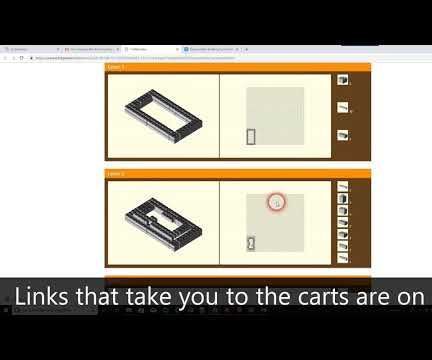

Step 3: Your Layer-by-Layer LEGO Brick Build Plan
Depending on the selection size the email usually shows up in 3 to 30 minutes.
- It starts with a 3D STL file Download button for all guys wanting to 3D print their Minecraft creation.
- For the LEGO fans the button to pick is at the bottom right and is named Download Brick Layers.
- Once clicked, it takes you to a page containing a 4-layer preview of your LEGO layer-by-layer brick build plan. If you selected a model small enough to qualify for FREE delivery, you can select the GET YOUR PLAN FOR FREE button at the top of the page to get to the full build plan for all layers.
If you happen to own all LEGO bricks you need, you are set for your Minecraft LEGO adventure.
For all of you that are missing a few or all of the required LEGOs, the system has generated a (completely optional) Brick Owl shopping basket for convenience.
Brick Owl provides a worldwide online marketplace service to allow customers to connect with stores selling LEGO and LEGO related items. These stores independently market, sell and support these items.
Every layer of the build plan shows two sides. The left side shows your progress and the right side dop-down where to put your bricks. Stud-by-stud. The previous layer is shown as a reference with dimmed gray bricks.

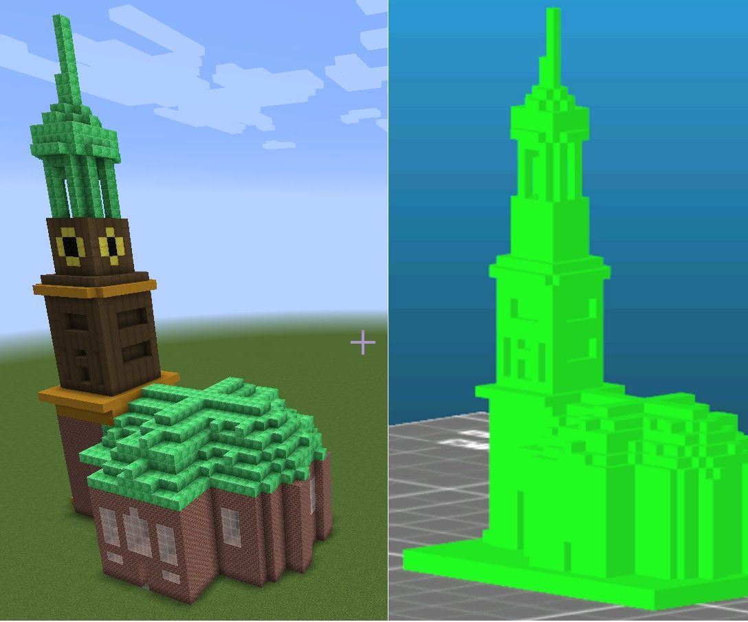

Step 4: When You Done...
... you might end up with something like this.
