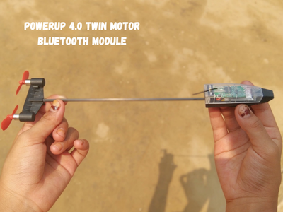

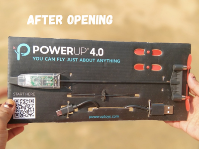

Recently I received a courier from Powerup Toys, while unboxing I got;)
  • POWERUP 4.0 twin motor bluetooth module

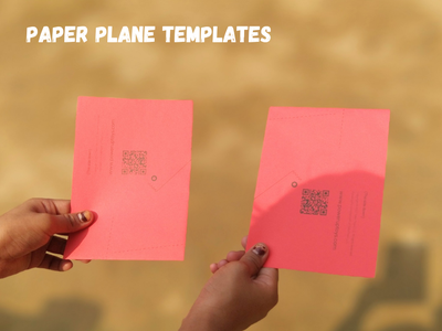

  • Paper Plane Templates

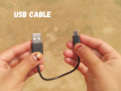

  • Micro USB charging cable
  • Crossbar
  • Spare Propeller Set
  • Trim Card
  • Quick Start User Manual

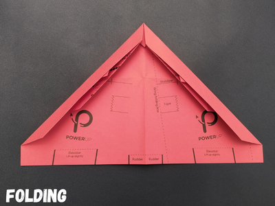

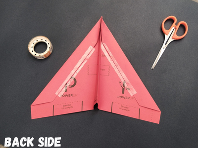

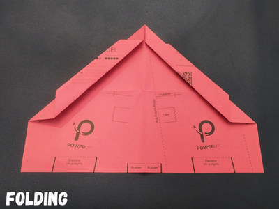

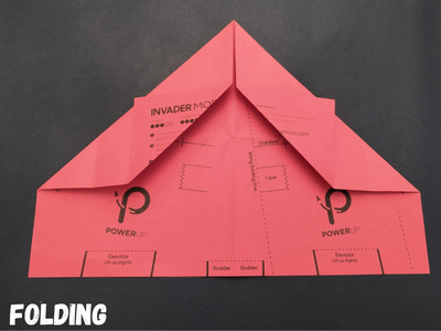

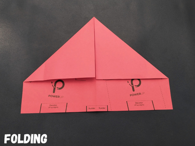

Step 2: Folding Paper
Since I have not an experience that how to fold the paper in the right way. So I searched on YouTube and Found a one of the BEST VIDEO that how to fold the paper in right way. You can also follow these steps to fold the paper;)
  • Start with a Plain Sheet of Paper: Place the paper on a flat surface in portrait orientation.
  • Fold the Paper in Half Lengthwise: Fold the paper in half vertically, creating a crease down the middle. Unfold to create a guideline.
  • Create the Nose of the Plane: Fold the top two corners down to meet the center crease, forming a triangle at the top.
  • Fold the Top Edges to the Center: Take the outer edges of the triangles you just created and fold them to the center crease again, making a more narrow triangle with a pointed nose.
  • Create the Wings: Fold the paper in half along the initial center crease so that the previous folds are on the inside.

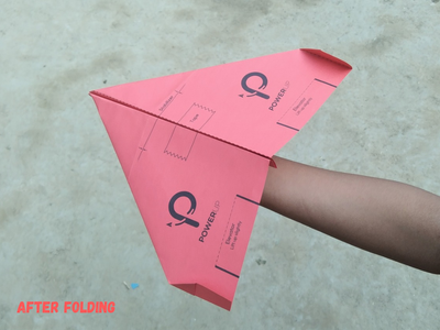

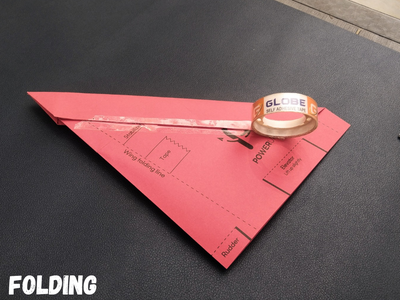

  • Form the Wing Creases: Fold the outer edges down to the bottom edge of the plane to form the wings. Make sure both sides are even. These folds should be parallel to the center crease and create a straight edge along the bottom.
  • Adjust the Wings for Flight: Unfold the wings slightly to give them a slight upward tilt. This dihedral angle helps stabilize the plane in flight.
By following these steps, you should have a well-folded paper airplane that works effectively with the Powerup 4.0 module. Also check all the attached pictures for your reference;)

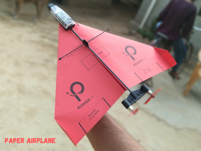

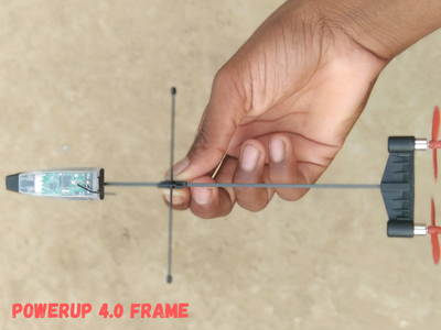

Step 3: Attaching Frame
After Folding the paper, Clip the Powerup 4.0 module to the center crease of the paper airplane. The module should be positioned at the front with the propellers and motor assembly extending behind the plane. Now attach the crossbar with the paper plane.
