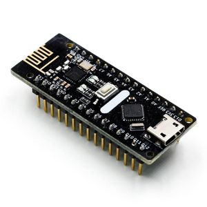

nRF Nano (buy one from aliexpress)
This board combines the NRF24L01+ wireless transceiver with the familiar form factor and programming paradigm of the Arduino Nano. For someone who needs wireless capabilities and prefers to keep solder and wiring work to a minimum, this board is a good option.
or Arduino Nano + nRF24L01

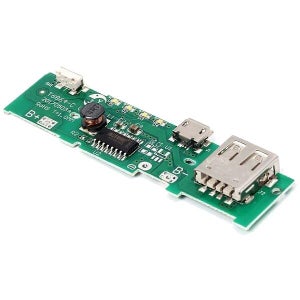

Power Bank Charger Circuit (buy from aliexpress.com)
This power bank circuit uses two integrated modules. The first module is a lithium-ion battery charger and the second is a DC-DC boost converter module.

For bringing the wireless functionality in the remote we will use Arduino Nano and nRF24L01 wireless transceiver. I will place the Nano board and the nRF24l01 module in a perf board and connect the data and power lines of the controller circuit.
I used an anti-cutter to cut the perf board according to my measurements. The size of the PCB piece I prepared is 10CM X 2CM.
PCB will house the Arduino Nano, nRF24L01 wireless transceiver, and the Li-ion charger and boost converter circuit. I will use female headers to connect the Arduino with the PCB.

The connection between nRF24L01 and Arduino Nano
The connection is exactly the same on both the transmitter and receiver end.
Connect the GND pin to -ve and VCC pin to 3.3v pin of Arduino. The signals generated by these modules are very sensitive to power supply noises. So, adding a decoupling capacitor (anything from 10uF to 100uF) across the power supply line is always a very good idea.
Then connect the CSN pin to D9, CE to D10, MOSI to D11, MISO to D12, and SCK to D13 pin of the Arduino.
Since the nRF24L01+ module requires a lot of data transfer, it will give the best performance when connected to the hardware SPI pins on the microcontroller. Note that each Arduino board has different SPI pins that must be connected accordingly. Have a look at the table onscreen for a quick understanding.

Three of these pins are for the SPI communication and they need to be connected to the SPI pins of the Arduino, but note that each Arduino board has different SPI pins. The pins CSN and CE can be connected to any digital pin of the Arduino board and they are used for setting the module in standby or active mode, as well as for switching between transmitting or command mode. The last pin is an interrupt pin which doesn’t have to be used.
Step 5: Battery Charger & Boost Converter
The converted RC remote will be powered by li-ion battery. Li-ion batteries required a sophisticated charging circuit that protects the battery from overcharge and deep discharge. The output voltage of a li-ion cell is 3.7V which is not enough for the PS2 internal circuit. So, I converted that voltage to 5V using a boost converter circuit. The good news is that the li-ion charger circuit and boost converter circuit are available in a single PCB. That is called power bank circuit, generally used in power banks.
So, I used a power bank circuit to charge the battery and as well as to step up the voltage to 5V. I cut out the USB output port from the PCB as it is not required in our case.
