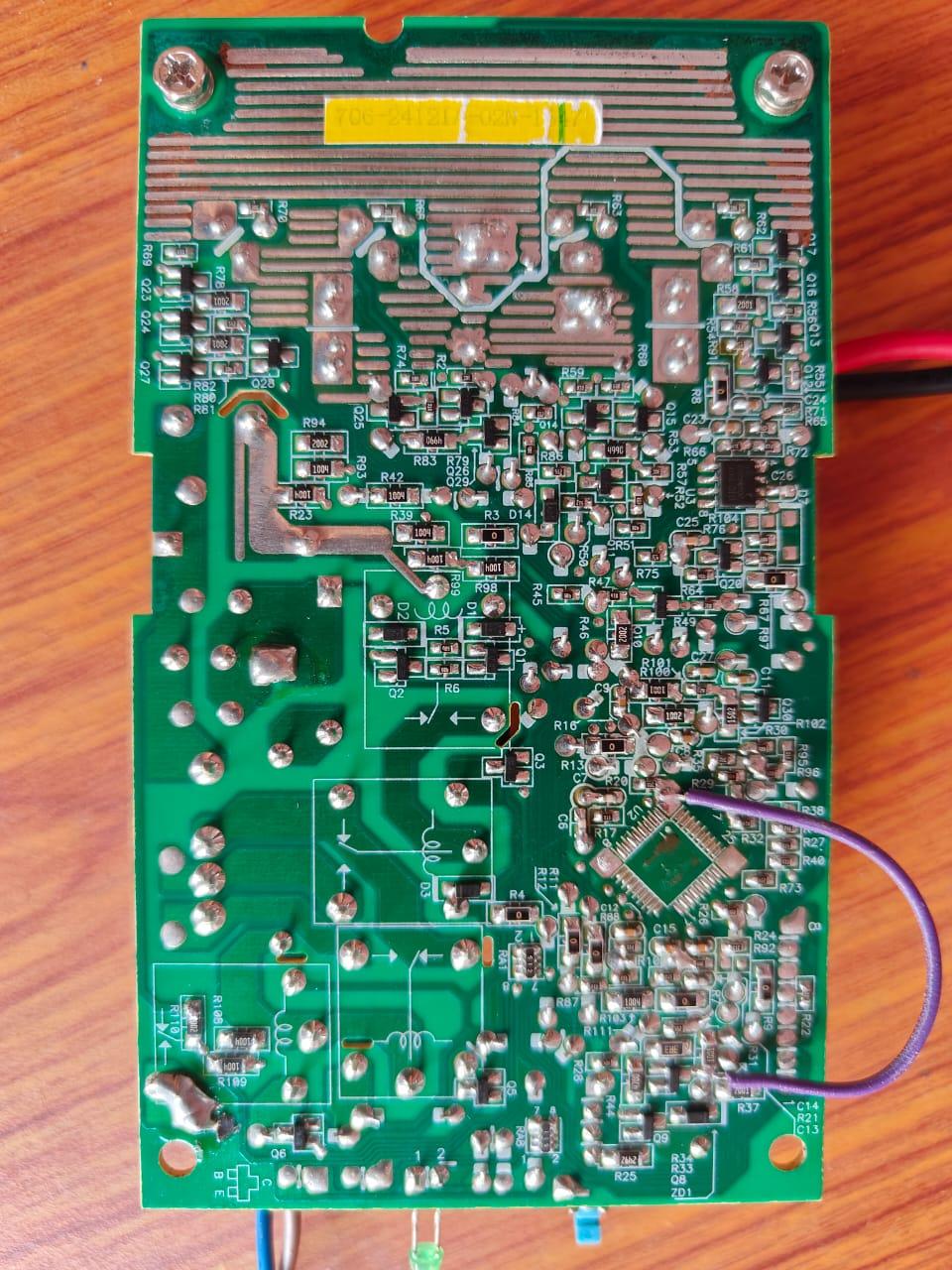

Step 1: Remove the Dead Microcontroller IC
Begin by removing the non-functional microcontroller IC from the UPS circuit board.
  1. If the IC is in a DIP (Dual In-line Package) form, you can easily desolder it using a soldering iron and solderwick.
  2. If the IC is in an SMD (Surface-Mount Device) package, use a hot-air soldering station for safe and efficient removal.
Once the IC is removed, carefully clean any excess solder from the pads using solder wick and flux. At this point, your UPS board should look similar to the reference image.

You can easily identify this component on the board—it is a Through-Hole Technology (THT) device in a TO-92 package. In the provided image, I have highlighted it by drawing a red circle around the component.
Step 3: Activate the Power Supply Circuit for Charging
On the UPS board, there is a PNP bipolar junction transistor (BJT) labeled H2907A. This transistor plays a crucial role in supplying a stable +12V DC to key components such as the MOSFET driver circuits, relay, and the UC3843 charging controller IC.
To enable battery charging, it's essential to keep the MOSFET drivers and charging controller IC powered. This means you must ensure the H2907A transistor remains ON.
Since H2907A is a PNP BJT, it turns on when the base-emitter voltage (V_BE) is approximately -0.7V (i.e., the base is about 0.7V lower than the emitter).
In the UPS circuit:
  1. The emitter of H2907A is connected to the positive terminal of the battery (+12V).
  2. The base is connected to the collector of an NPN BJT (PMBT2222A) through a 1kΩ resistor.
  3. This 1k resistor is used to limit the base current of the PNP transistor.
To force H2907A into conduction and turn on the 12V supply rail:
  1. Connect the base resistor (the end connected to the collector of the NPN BJT) directly to ground (GND).
  2. You can do this by soldering a jumper wire as shown in the reference image.
This modification will permanently turn on the PNP transistor, thereby ensuring the +12V supply is active and the battery charging circuit is operational.

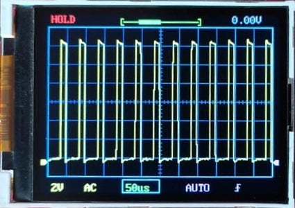

Step 5: Check the Charging Pulses Generated by UC3843 IC
In many computer UPS designs, charging pulses for the lower MOSFETs are directly generated by the microcontroller. However, in over 70% of UPS boards, a dedicated PWM controller IC UC3843AN is used for this task. The output of the UC3843AN appears on pin 6, which delivers the required PWM charging pulses.
To observe the duty cycle, frequency, and waveform of these pulses, I used a DSO138 oscilloscope kit. The waveform captured on pin 6 of the UC3843AN matches the images provided. The observed PWM frequency is 20 kHz, and the duty cycle varies from 10% to 30%, depending on the feedback voltage applied to pin 2 (VFB) of the IC.
For further verification, you can place the red probe of the oscilloscope or multimeter on the gate terminals of the two lower MOSFETs, one at a time. You will observe the same waveform as seen on pin 6 of the UC3843AN, but with a higher amplitude. This is because the MOSFET driver circuit boosts the signal level to ensure accurate and efficient switching of the low-side MOSFETs.

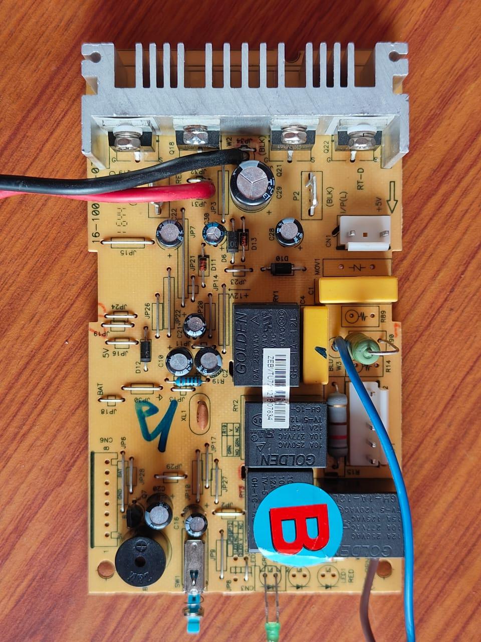

Step 6: Connect the Transformer to the UPS Circuit
To configure the transformer for battery charging, follow these steps:
  1. Connect the low-voltage (charging) side of the transformer:
  2. Connect the red wire of the transformer to the spade terminal P1.
  3. Connect the blue wire to the spade terminal P2.
  4. Connect the high-voltage (AC input) side of the transformer directly to the AC mains (do not connect it to the UPS board):
  5. Connect the black wire to the neutral (N) of your 230V/50Hz AC supply.
  6. Connect the green wire to the line (L) of the AC supply.
  7. Special case – Low mains voltage:
  8. If your mains voltage is below 190V, the transformer may not charge the battery efficiently through the green wire.
  9. In this case, connect the blue wire (instead of the green wire) to the line (L) of the AC supply.
  10. The blue wire is internally tapped for better charging performance when the mains voltage is below 200V.
⚠️ Important: Make sure all connections are insulated and secured properly to avoid electric shock or short circuits. Always take necessary precautions while working with 230V AC.
