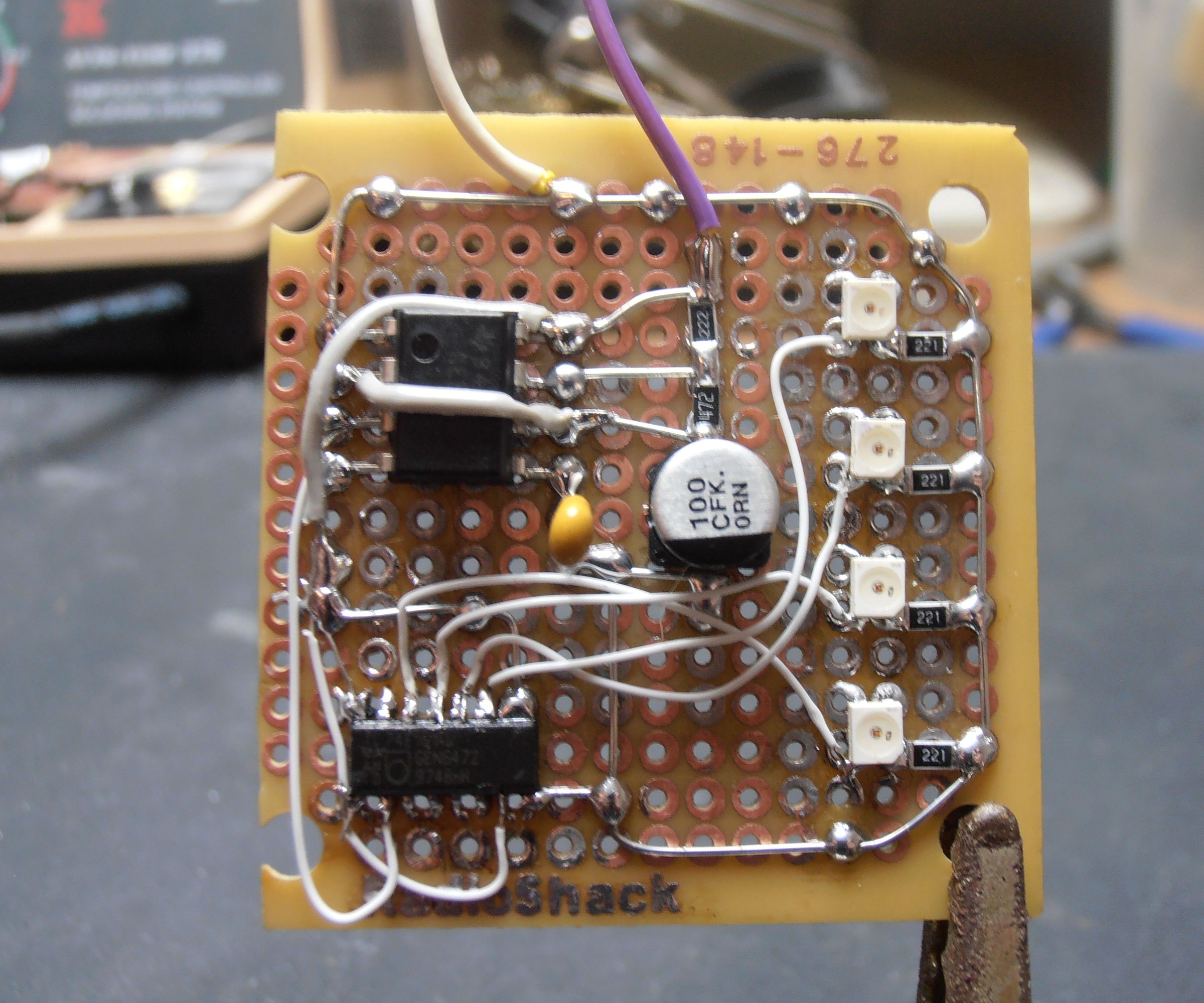

Step 10: Construction: Resistors
With the basics needed for the microcontroller to run we can hook up the resistors that are the first step in our level conversion from 5v to ~3v
First resistor to hook up is the 1k5 resistor, insert it into the top hole of where the cord used to plug into, solder it in place from under and just kinda bend its lead out of the way for now
Side note, I say 1.5k and picture a 1.0k, reason for this is I already have 100 3.3v diodes, and with the currents involved its only pulling the line up to ~2.7v instead of 3.3, this may be fine for my mutt open architecture computers but not all computers will "play ball", use 3.6v diodes and a 1.5k ohm resistor and when you do the math its around 3.2+ and will not cause issues with computers that dare things to be within spec
Now Take your 2 68 ohm resistor and solder a end to pins 4 and 6, trim their leads so they stagger a little at the opposite end and bend those leads to the right
Finally for this step add some jumper wires to the 3 resistors and clip them so they all end at the same place (I used red for the pull up resistor, and blue for the 2 data lines
Step 11: Construction: USB Cable (nearly Done)
Take the wires that lead from the pull up resistor (1k5) and one of the 68 ohm resistors that ultimately ends up on the mega's pin 6, and pigtail them together.
Also take the wire lead from mega pin 4 then strip and twist its end
Next take your diodes, and pigtail their cathodes (end with the stripe on it) to the other wires
Find the D- line in your usb cable, Mine was brown ... anyway do a inline splice with the pigtail that contains 2 wires and the diode, then solder together and wrap in tape, take the D+ line and splice it with the other wire that is coming off of the mega's pin 4 and the diode, solder them all together and wrap with tape
You should have the other leads of the diodes still sticking out, choose whichever one looks longer and solder it to the lead of the capacitor that is connected to ground (the other side would be connected to the crystal), then solder the other diode lead to the first diode lead so they are both connected to ground
Then solder the ground lead from the usb cable to one of the leads connected to ground
Step 12: Construction: USB Cable and Wrapping Up
The final connection is for the usb to provide everything with power, I was running a little tight on space, and really did not want to run another jumper wire... what to do?
Easy, cheat, plug the USB's +5 line into the last IC socket hole on the top of the board, this only goes 1 place, and it ends up right next to where we connected the pull up resistor, to power the rest of the board, we need to jump the first 2 pads where the cable used to attach
Wrapping up:
Plug it in and test it one more time, I added some glue on spots that I thought could bend easy or vibrate and you should too, although I am impressed with the NES controller strain control, I started bending plastic and the cable did not budge
Take this chance to really clean your controllers case, so you don't have old goo stuck between the buttons and the shell
As you put the controller back together there are supports in the back half of the shell, if you followed the pictures there should be little issue, just kind of peek inside as your closing up and do not force pinch anything, it might take a little poking to get everything happy
And most importantly enjoy!
