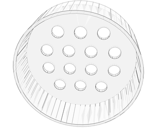

I am going to place the speakers inside the lags of the teddy bear. A protective case for the speakers is required otherwise the diaphragm of the speaker may be damaged as the teddy bear is a soft thing and kids like to play with it. So, I designed a case for the speakers using Thinkercad. The design file is included. The outer radius of the speakers is 45mm, so the inner radius of the case should be 45mm to set it perfectly with the speaker. I used very low price Anet A8 printer to print the cases and the print quality of the printer is very good.

After printing the case you have to put the speakers in the case but before doing this you must solder some wire to the speaker. I soldered a 1-foot long doubled jumper wire to each of the speakers. Then I placed each of the speakers in the case. Both of them are now safe from the kids.
