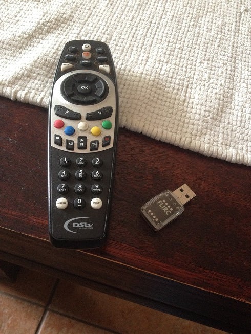

How do you navigate it after it's been striped? Also do you use some sort of remote instead of a keyboard/mouse to navigate?
Reply 9 years ago on Introduction
Yes I use a USB IR receiver called Flirc. It learns any IR remote and is only programed once.
But there are a few other options you can use. XBMC has a remote app that runs on Android and iOS.
Or there are a few cheap remote controls on ebay. Otherwise a standard wireless keyboard works cool.
