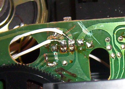

Here is the top side of the tape head where the wires *were* attached. I've already desoldered the four wires from it (positive and negative wires for the left and right channels).
To desolder the wires, just plug in the soldering iron and let it get fully heated up. Then just hold the tip of the iron to the solder pads while gently pulling on the wire. When the solder heats up enough to melt, the wire will come loose.

In order to play an MP3 Player through the boombox, the plan is to hook the headphone output of the MP3 player to the tape head wires. One could just buy a 1/8 inch stereo phono plug from a place like Radio Shack and let that plug hang out of the boombox to hook to the MP3 player, but I didn't want to spend any more money on this project that I had to and didn't like the idea of having the wire hanging out and all, so I decided to re-use the headphones jack in the old boombox. The jack was soldered into the circuit board such that it poked through the top of the case so I didn't want to completely remove it and have to come up with a way to attach it.
To use the jack, I knew I needed to disconnect it from the rest of the audio circuit. To disconnect it with it still in place, I actually used a small screwdriver to scrape through the circuit traces so the headphone jack would no longer be really attached to anything. See the notes in the picture for other details.

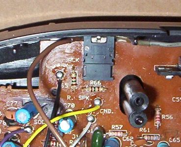

I have an idea though. When I was figuring out the old tape player's headphone jack (which I "repurposed" as the input from the MP3 player), I saw that while the normal output of the tape player went straight to the speakers, the headphones output was routed through a couple of resistors (one per channel) to drop the strength of the output down to headphones level (to not blow the headphones...*or your ears*).
I'll try re-routing the MP3 input through those resistors and see if that helps. The second pane below shows them.

Step 8: Move the Input Wires to Resistors
Now we'll move the old tape head audio wires from the headphones jack over to those resistors in hopes of cutting down the strength of the signal.

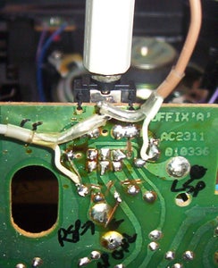

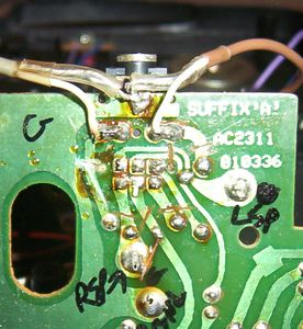

Adding resistors didn't seem to be helping; then I got a suggestion from another great Instructables user, unknownuser2007 He suggested that instead of trying to use resistors to drop the level of the headphones output of the MP3 player, I could try bypassing the cassette head preamp IC like he did in his instructable. A great idea!! Thanks unknownuser2007!

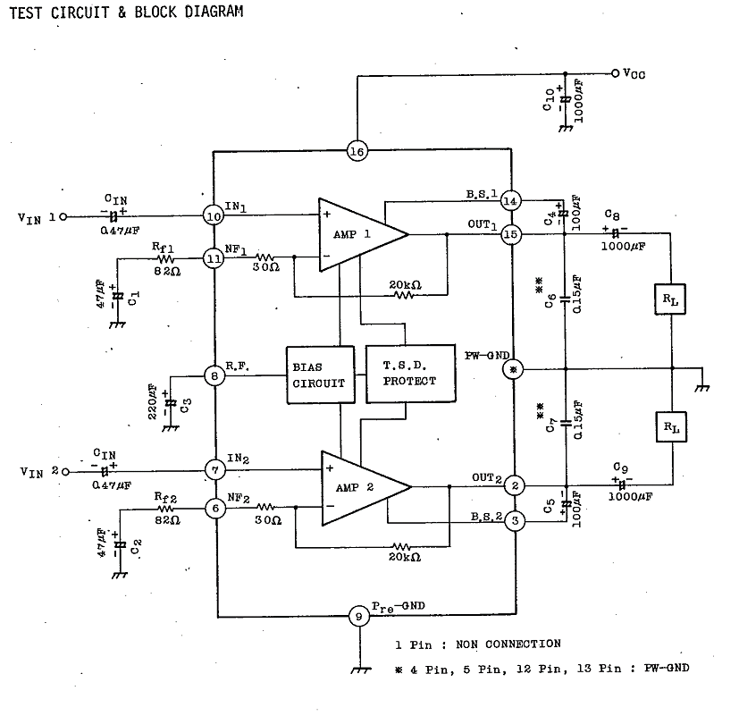

The tape head wires (which I am using as the input from the MP3 player) are attached to the circuit board and traces ran from there to an LA3220 IC chip (see second pic). I looked up this chip on at a great Data Sheets website (see third pic) and found that it is an Equalizer Amplifier that is apparently acting as a preamp for the tape head.
There's another IC, an LA7769 (fourth/fifth pics) whose output goes straight to the speakers. This IC is apparently the main, higher power amplifier for the speakers.
"OK", I thought. "Great; its just what I need to amplify the headphones output of the MP3 player! I'll just move those input wires straight to the input of that IC".
Well, it worked, but then the sound was very loud all the time, even with the MP3 player's volume set at its lowest setting of "1"...bummer..so close!!
Well, one last idea....see next step
