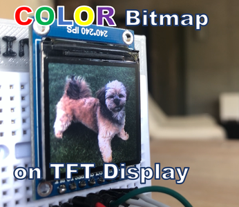

Introduction: Convert and Display Color Images on an Arduino TFT Screen
This project demonstrates how to display colorful bitmaps on a TFT screen using an ESP microcontroller. It involves converting images to RGB565 format and transmitting them via serial communication from a PC to the microcontroller, , which then displays them pixel by pixel.

Step 6: Displaying Your Bitmap on the TFT Display
Few final steps to execute:
  • load the sketch to microcontroller
  • connect the Coolterm application to Microcontroller
  • drag and drop the converted image to Coolterm
You will see the progress bar in Coolterm and on TFT you will see the image being displayed line by line.
