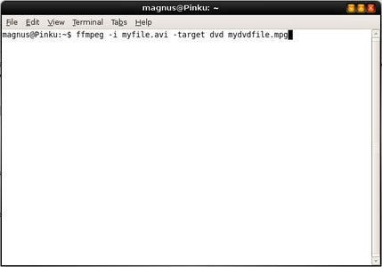

Step 2: Converting Video
The basic command for converting video is: ffmpeg -i inputfile outputfile
The format of the output video comes from the file extension you specify on outputfile.
It can be any video format: flv, avi, mpg...
example: ffmpeg -i input.avi output.mpg
Now we start adding parameters.
parameters are options for converting video. they are in format: ffmpeg -i myfile.avi -parameter output.mpg
There are a number of parameters:
-ab -audio bitrate
-b -video bitrate
-sameq -produces same quality video, as the input
-target -target can be "vcd", "svcd", "dvd", "dv", "pal-vcd" or "ntsc-svcd".
example: ffmpeg -i myfile.avi -target ntsc-dvd mydvdfile.mpg
This makes a dvd video file
