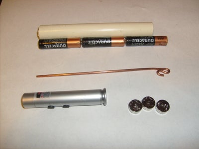

Parts and pieces. (Bits and bobs)
A laser pointer that used LR44 batteries.
3 AAA batteries.
at least 4 1/2 inches of 1/2 CPVC pipe
6 inches of 14 gauge wire

First, cut a length of 1/2 inch CPVC pipe a bit over 4 1/2 inches long. 4 and 5/8 worked for me, but I don't think it's all that critical. It is important that the pipe is CPVC. PVC will not work! The inside diameter must be such that the batteries and wire fit snug.

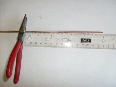

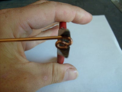

Then bend an "S" on the end of the 6 inches of 14 gauge wire. Once again, 14 gauge was critical, as 12 would not fit, and 16 was too loose. I am remodeling my house, so I used a piece of ground wire. Magnet wire would work well, but don't forget to sand off the insulation where it touches the battery terminal, and where it touches the inside of the case of the pointer.
Then, put a battery with the bump end (+) touching the "S" of the wire, and slide this into the pipe.

Make sure the "S" bend of the wire is on the terminal, not beside like the photo shows.

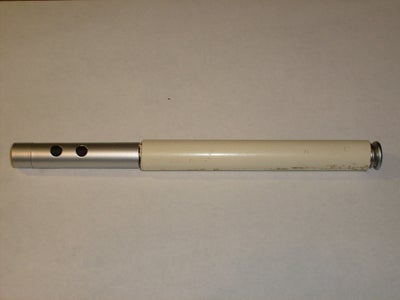

Replace the cap if you so desire. The "S" can be bent so it helps keep the cap on if the cap is too loose in the pipe.
I had to stand the completed assembly upright on my desk, and push everything together tightly to get all the batteries and wire to make contact.
