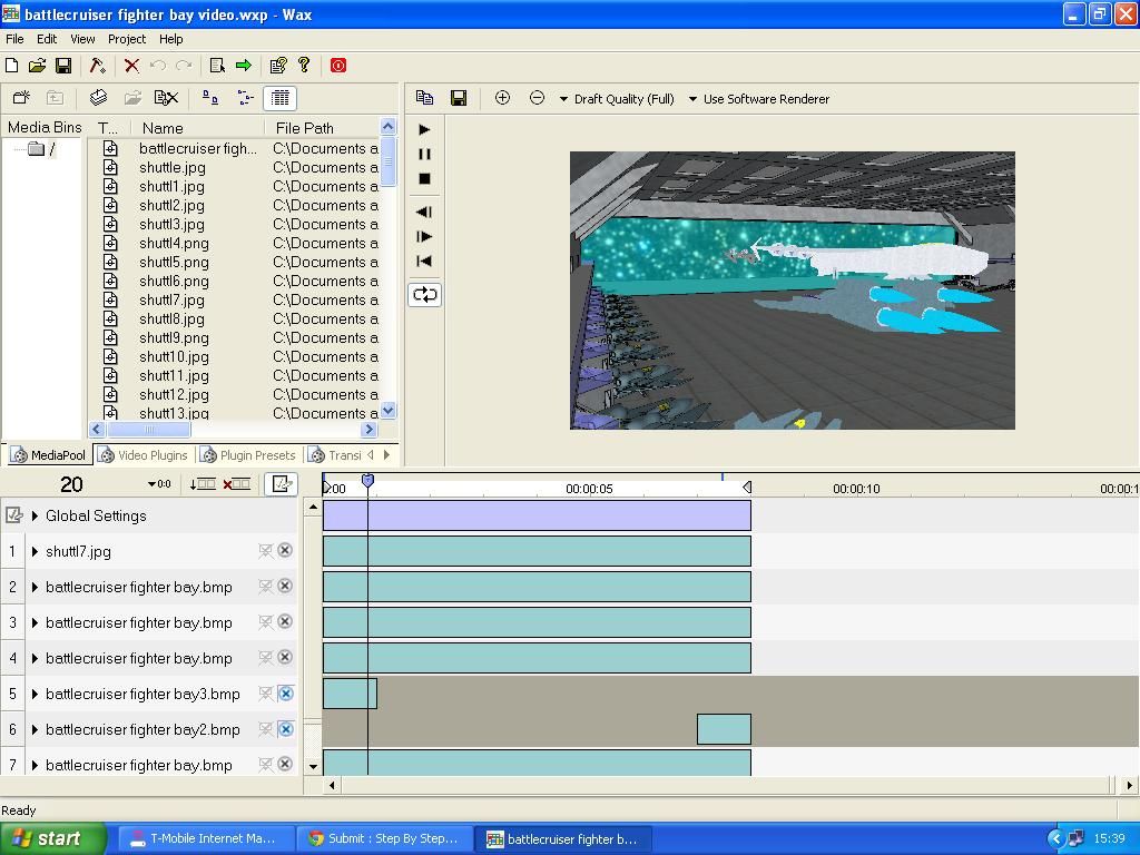

PLEASE NOTE: my new instructable on using sketchup and blender has a more detailed tutorial on this conversion process, it should help explain anything that this does not address. it also shows what to do once the model is in blender.
