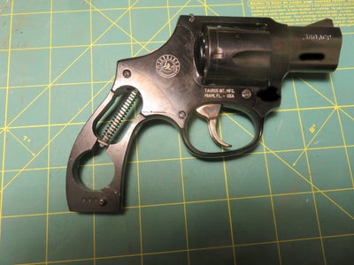

Step 1: Remove the Grips

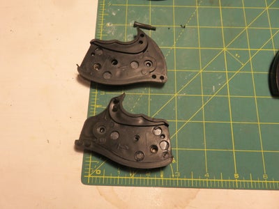

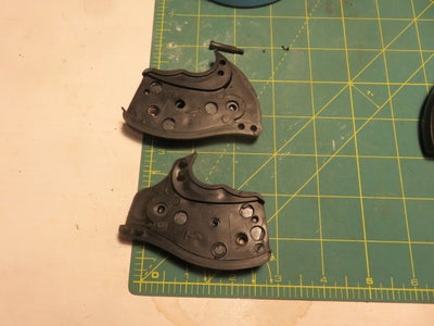

There is one screw to remove the grips, the grips have to be pried off because a small alignment pin on the frame. Be sure to keep mating parts together in an order that you will remember how to reassemble the parts.

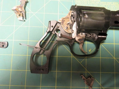

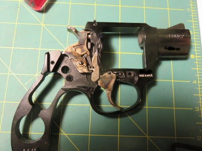

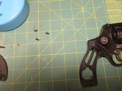

Step 2: Remove the Side Plate
There are three screws holding on the side plate. The two closest to the grips are the same. The screw under the cylinder and above the trigger is unique as it also holds a part that hold the cylinder. I did not remove the part, but kept the hole plugged when moving so the part did not fall out. The cylinder does have to be removed to get the hammer and trigger changed.

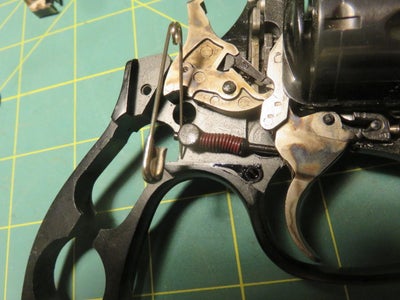

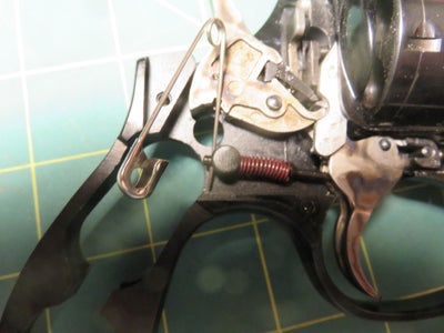

Step 3: Removing the Hammer and Trigger Springs

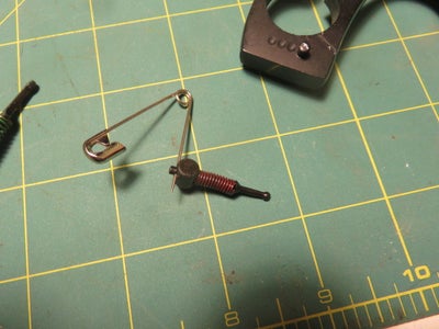

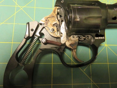

The next step is the remove the hammer. Cock the hammer (with no spur you pull the trigger and then stick you finger or thumb between the hammer and frame and force the hammer to the full cock position) When the hammer is at full cock insert a paper clip in the hole on the grip end of the hammer spring. Allow the hammer to drop and the spring and center pin can be removed, note the center pin is in recesses to capture the pin.
Next the trigger return spring is removed. Pull the trigger and hold in the fire position. There is a hole in the center pin, this hole is smaller than the hammer center pin so a safety pin is used to contain the spring. The center pin has a pin that is anchored in the frame and you may have to push the pin from the opposite side of the frame.

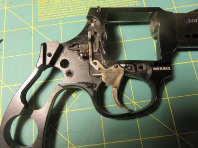

Now the springs are out.
Follow the instructions with the spring kit you have to replace the hammer and trigger springs. Then reinstall the keepers (paper clip and safety pin). Aside for reassembly.

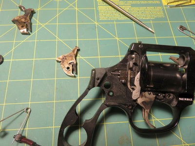

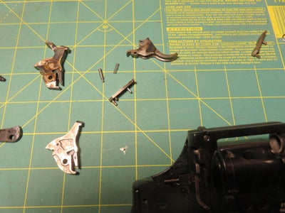

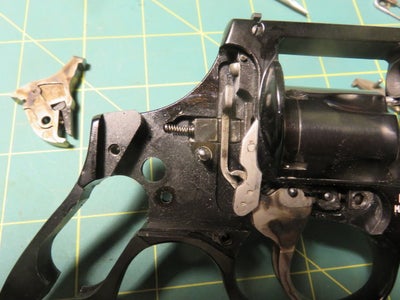

Step 4: Remove Hammer and Trigger
Remove the hammer and trigger, (slight prying may be needed) There is a hand plunger and spring in the trigger that will "shoot" out when the trigger is removed. If you cup your hand around the frame and trigger guard and the parts should land in the palm of your hand. The hand part will also have to be removed.

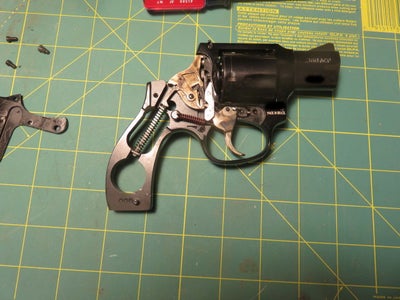

Step 5: Installing the Replacement Hammer, Hand , and Trigger
The hammer, hand, and trigger were purchased from a 38 special model. (I think all I needed was the hammer, but did not know if the trigger or hand were different between double action only and single/double action).
The replacement parts were installed. The hand plunger and spring were replaced in the trigger.
Any smoothing of parts should be accomplished before reassembly.
Clean any dirty areas and apply light oil to all contact areas.
The hammer and trigger springs are reinstalled. (remember the slots and hole in the frame for alignment)

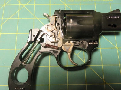

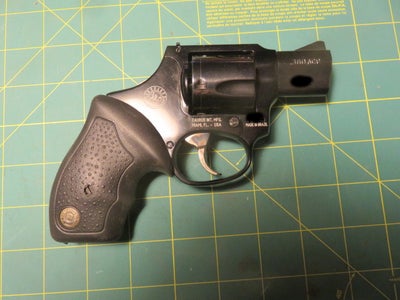

Step 6: Reinstall the Side Plate and Grips
Reinstall the cylinder. (make sure the part under the side plate screw is in place)
Reinstall the side plate
Reinstall the grips. (remember the alignment pins)

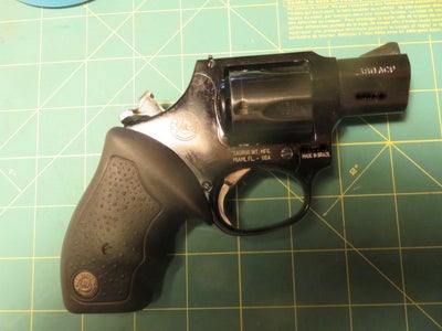

The single action works. The trigger pull for about 1/3 of the double action pull. (do not have a trigger pull gauge)
The double action pull is about 25% less than original and much smoother, the pull is very uniform with no rough spots.
