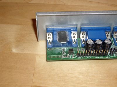

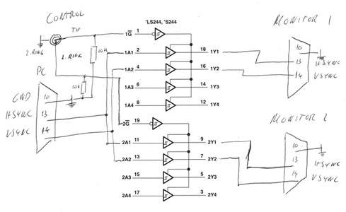

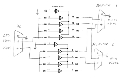

I've traced the HSYNC (pin 13) and the VSYNC (pin 14) of the PC VGA connector to the 74LS244 logic chip, a tristate bus driver. Both output enable signals were connected to ground to enable all lines. This chip interestingly allows to tristate its 8 lines in groups of 4 and by this this bus driver already provides the flexibility to turn the sync signal for both outputs independently on/off. See schematics and datasheet.

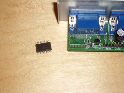

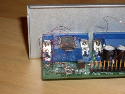

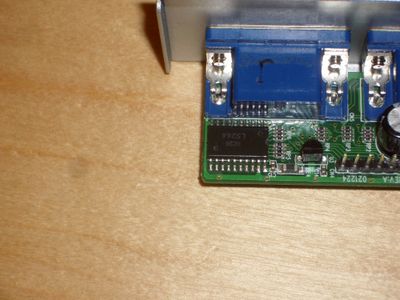

As I had to rewire the signals to the IC, I desoldered the chip from the PCB (accidentaly destroyed all pads , too). Then I used double sided tape to glue it on a VGA connector for easier soldering.
Step 3: Wiring the Monitor Switcher

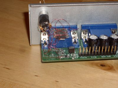

I had to re-wire it in such a way that the sync signals for the first VGA output were enabled by the upper half of the logic chip and the second by the lower half. To enable its use without a computer, I've used 2 pull-down resistors with 10 k to enable both outputs per default. The resistores are shown in the next step. See schematics.
Step 4: Adding the Control
A normal 3.5 " headphone jack was added into the rear terminal to access the control lines.
