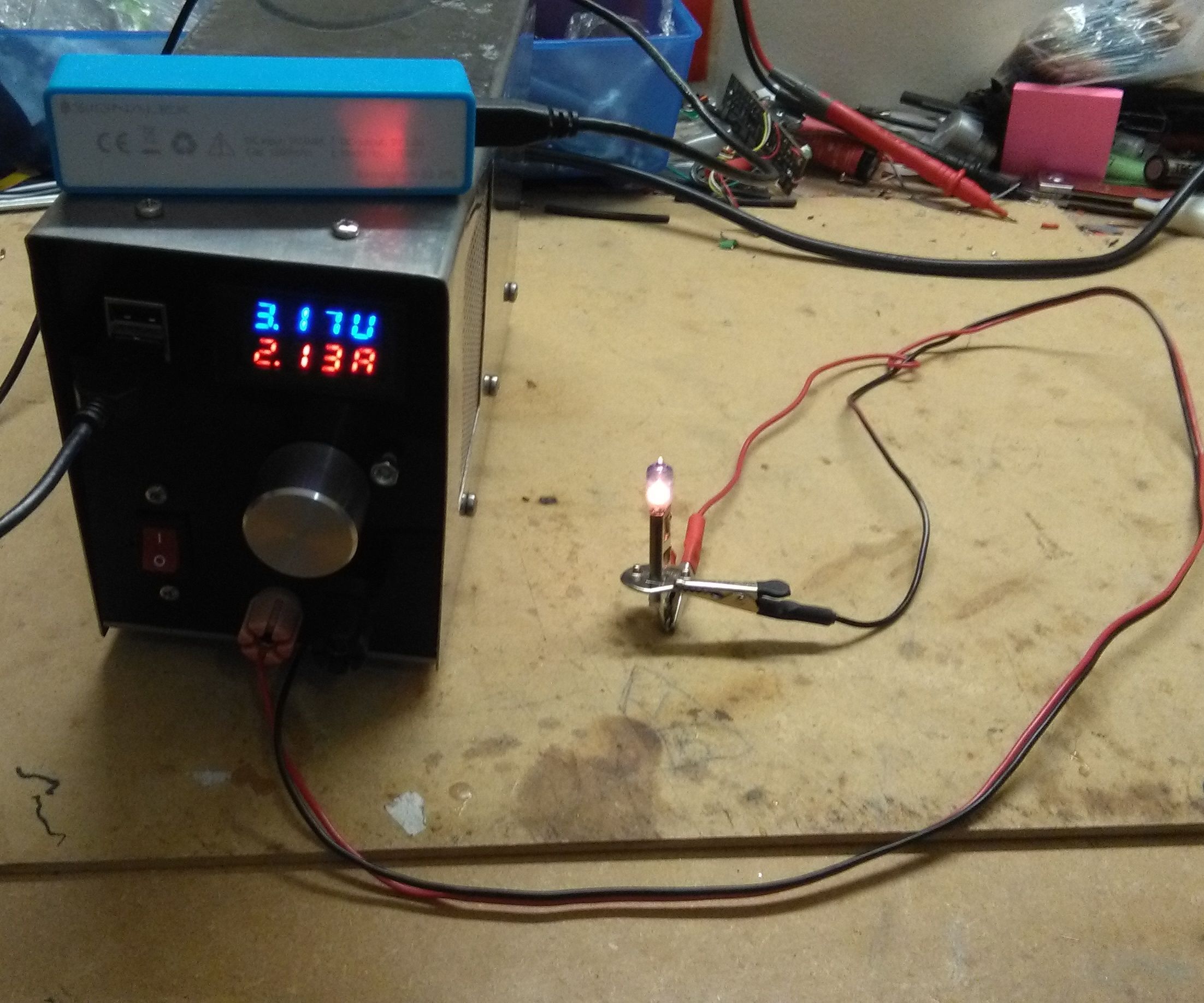

I applied 5V to the board from a power supply and measured the output voltage of 6.56V. This reading is slightly higher than what I wanted, but as there's a zener regulator for the microcontroller this is an acceptable voltage level.
Step 5: Reassembly of the Bulb
With the metal end cap removed, a wire can be passed through the small hole in the base. In this case I show a short USB cable being used, but you could also use any other type of cable for connecting directly to a battery.
I tied a knot in the USB cable for strain relief, a cable tie would work also. The ends of the USB cable are soldered onto the modified boost converter which is then connected directly to the bulb's DC side.
