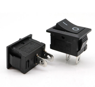

I also used a 40mm fan, and later ended up using a rocker switch, type c boards, and some wires too.
Type C Breakout Boards: https://www.aliexpress.com/item/1005005874481984.html
(I've uploaded the datasheet that i found on the listing, though it is the incorrect one in terms of pins. For the dimensions, it worked well while I was designing the cutout for it.)
Rocker Switch: https://www.aliexpress.com/item/32873386670.html

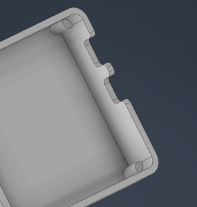

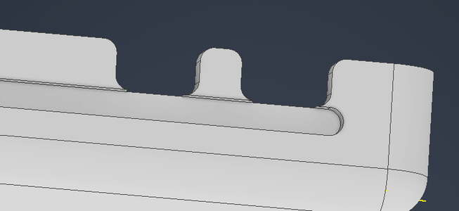

Step 7: Back to the Drawing Board!
After noting the said design issues, I decided to hop back into inventor to fix things up. I've added a note to each image to show what change I made to it. Feel free to take a look and improvise your own design from this!
(P.S. apparently instructables doesn't like me, deleted all my notes, and won't let me add new ones. So, I'm just gonna type them out here!)
1- Increased speaker cutout length, added fillets to inner edges
2- increased fillet radius (4 to 6mm)
3- increased volume an power button cutout length
4- added supports on the corners to keep phone from falling inside the case and touching internal components
5- adjusted and increased fan channels to allow the fan cable to be routed above
6- reduced hole size for wires to pass through after allowing space on top
7- made side insets larger to allow for the controller to fit in easily
8- inset for controller, closeup
9- supports extruded
10- cutout for passthrough charging cable
11- type c cutout for the breakout board (used datasheet for dimensions)
I also made some design changes here. I decided to add a hole on the right side, to allow for a type c cable to pass through it for charging. I also made a cutout at the bottom for a type c connector, which would be used to both charge the phone, and power the fan. I ended up adding a switch at the top of the case later on, which controlled the power going to the fan. I'll explain these changes in a bit as well.
