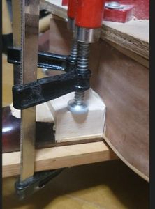

Step 6: New Heel Block
I put in a new block of beech where the new sides are going to attach below the neck. I was trying to keep everything in the same plane here so that the neck angle wouldn't get too out of shape.

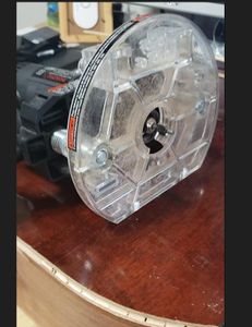

Step 9: Bindings
The only power tool I used was my dremel in my plunge router attachement that I use for bindings. I didn't want to bother bending too much wood, and I was able to find some thin bamboo strips that were flexible but still pretty hard, so I used those and it worked pretty well.

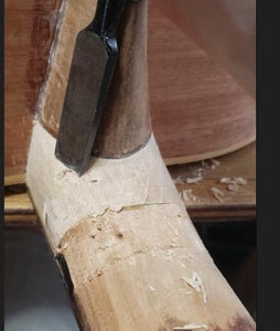

Step 10: The New Heel
Now I could glue in a new block of wood between the existing neck and the neck joint, and then glue the old heel on top of that to create a whole new heel. I used epoxy for these joints because the fits were not perfect and epoxy fills spaces. Then I carved the new block into a nice heel shape with chisels and knives.
I was a little worried about the strength of the joint between the new block and the old neck, so I decided to strengthen it by sinking two long wood screws under the neck as shown. I don't know if this was necessary, but I think it will at least make it strong enough. I then had to glue in a piece of the old neck to cover where the screws are. I used part of the neck that I cut off (old frets 1-3) for this.

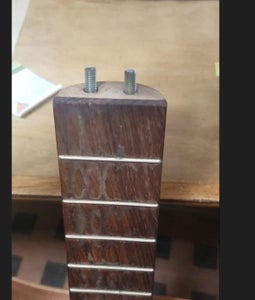

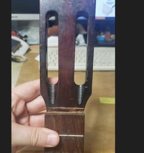

Step 11: Reattaching the Headstock
This was the part I was most worried about in the whole project. I wasn't sure how I could get a good strong joint since I was attaching the head with an end-to-end joint with a pretty small gluing area. I found a page online that recommended using metal threaded rod in place of dowels with a good amount of epoxy to make this kind of joint very strong. So I decided to use two pieces of threaded rod and make the holes as deep as possible. I used fast-acting epoxy because there was no way to clamp this joint and I had to just hold it by hand until it set.
It was hard to make sure everything was lined up right and hold it still, but in the end I managed to get it pretty close. There are probably better ways to do this. Anyway, it worked out somehow.
