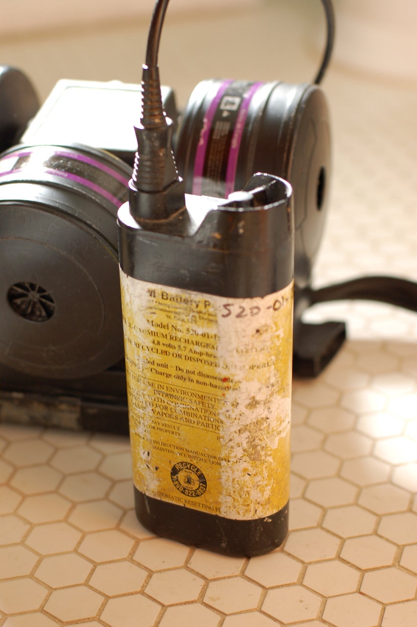

This is the old battery, a 3M 520-01-15. It is a made of four NiCd cells in series yielding 4.8V nominal output and is rated at 5.7 amp-hours capacity. The battery is very ruggedly constructed, important because it hangs off the belt of the PAPR and tends to take a beating in the course of normal operation.
