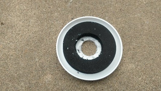

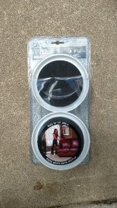

For each of the 4 outside risers I glued two 1" slip to male threaded ends to a 13 3/4" 1' pvc pipe. I drilled fourteen 3/4" holes in the pipe. For the top and bottom caps I used 4" furniture sliders that have a foam pad witch seals the ends to the filter. I drilled a 7/8" hole in the center and removed a 1 1/4" dia section of the foam . The bottom cap is secured with electrical nut. I needed it to be low profile because this end will thread into the 90 deg street elbow. The top is secured with a 1" threaded cap.

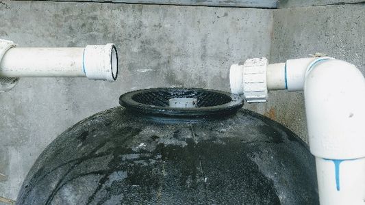

The last picture shows it installed inside the tank. To install it I had to disassemble it and reassemble it in the tank.

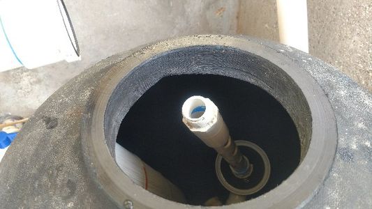

To get the length of the center riser I used 1 1/4" electrical pvc conduit (I had lying around) slipped it into the hub that was still in the tank and just marked it so the top of the riser is flush with the top of the opening. Then cut it to that length, again drilled fourteen 3/4" holes (I could have drilled more but didn't see any benefit, because the 14 hole have a greater flow rate than the risers dia.). I made a stop for the filter out of a 1/2" peace of 1 1/4" slip coupling (tapered at one end to seal the bottom of the filter) and a 1/4" peace of 1 1/2" pipe glued over the coupling peace to give it an extra shoulder. I slid it onto the riser a few inches up from the bottom, installed it into the hub again, slid a filter over the riser and then installed the valve body on top. Removed the valve, filter an the riser being carful not to move the stopper. Once out I marked its position I then glued it onto that spot.

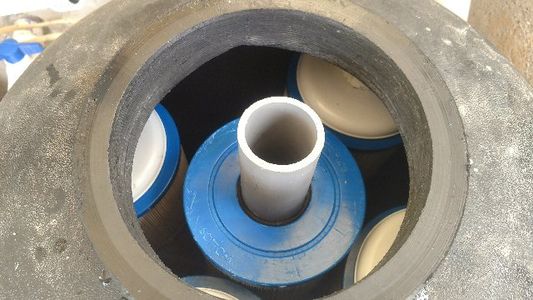

Installing the filters was pretty strait forward. For the outside risers my first plan was to assemble them with the filters and just screw the into place. This was problematic due to such a small opening . I had to install the outer risers first and angle them so I could slide the filter over them, and install the top caps (hand tight). The center riser went flawlessly slip the riser into the hub, slide the filter over it, and installed an o-ring over the riser, then installed the valve and connect all the plumbing.
