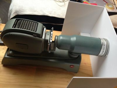

Step 1: Making the Slide Mount Suround
1. Measure you cardboard out , to about 30cm x A1 . Cut to size. ( Height will depend on the intended height of your light source.)
2. Measure equal folding sides of approximately 15cm each - score along lines and fold as above.
Step 2: Cutting the Light Hole and Diffuser Mount
1. Measure the height to the center of your light source and mark.
2. Draw a 5cm square around the center and cut out.
3. Cut the plastic plate to approximately 10cm square and fix over the opening with scotch-tape. Make sure this is the side facing away from the light source.
4. If you place it in-front of the light source now you will begin to see the effect.
5. Next cut the polystyrene board to fit and secure under the light defuser plate - turn the light on so that you can get it level with the 5cm square cut out. ( I've used rolled tape to double sided, you can use double sided tape or prestic or wood glue also).
6. You should then be able to balance a slide on the mount block as indicated above.
Step 3: Stabilizing the Slide Mount
1. Take the 2 polystyere blocks , and secure at the base of the mounting board with the sides folded in, To get a good 90 degree angle i've used 7 x 7 cm blocks but anything close would also do.
2. Now move the mount against the light source.

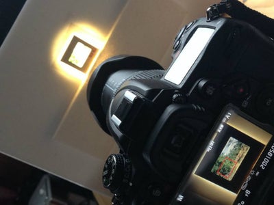

Step 4: Seting Up the Camera
1. Place the slide mount on a stable surface. Bare in mind that you will need to sit behind the camera and move the sldes to make sure its at a good height for that.
2. Set up your tripod and affix your camera in place, ensure that everything is plum using the spirit levels found on most tripods.
3. Side your trip pod at 90 degrees to your table.
4. Zoom in an check the zoom length. Adjust until you have reached the maximum zoom your camera allows ( the better the zoom the better your images will turn out.
5. Set your camera to fully manual. and place a slide in font of the mount for testing.
6. Set your camera setting till the image appears as close to the original as possible. I've used shutter speed 325 and F stop 8.
7. You are now ready to begin your recording.
