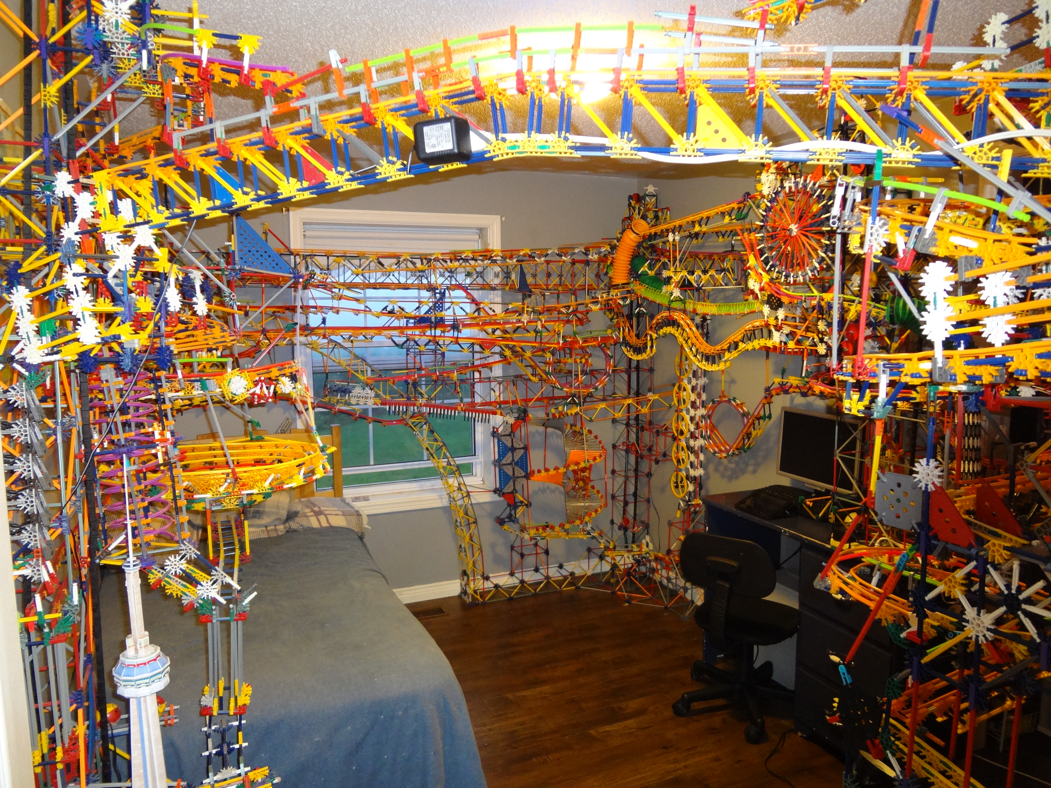

This is Convolution, my latest ball machine! It's been a long building process, enjoy!
Some stats:
-6 lifts
-6 motors
-15 balls
-24 tracks
-30 834 pieces
There are many new elements in this machine, such as the inverted top-hat, the giant helix and the quintuple interlocking loops.
Construction lasted from July 2013 to August 2014.

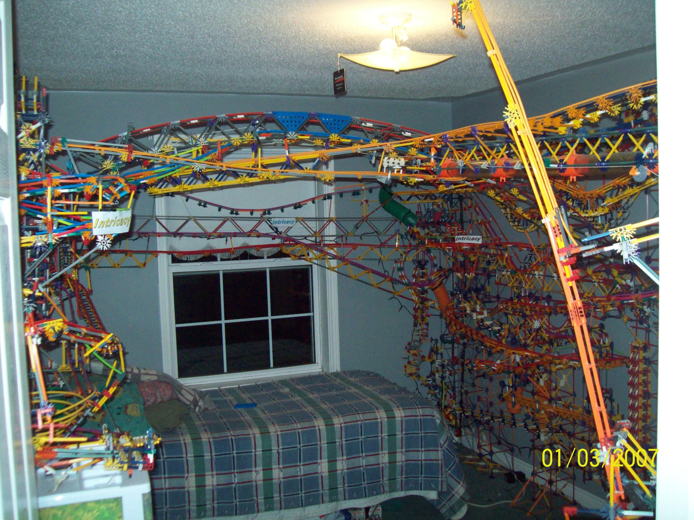

I always make some plans before I start my new machines. First, I plan it out roughly in my head, then jot down some sketches, and sometimes make a digital blueprint (both seen above). These plans serve purpose to where I want to place my furniture, as well as the main support beams of the machine. The plans may change slightly over the course of the construction of the machine as well. The second picture is closer to the final product than the first one, but both were useful in the planning of the machine.
