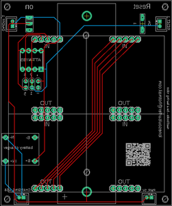

My contribution is, I created a PCB and front panel for the project and have tweaked some of the parameters in the sketch to make the game run faster and longer.

We all have different levels of knowledge, so when it comes to a build like this I want to make sure that I'm providing enough information so anyone with some basic soldering skills can make it. That includes ensuring there are instructions on how to get your own PCB's printed (which is super easy!)
So with that said, the first thing you will need to do is to get the front panel and PCB printed. I use JLCPCB (not affiliated) to get this done. The front panel is actually just a PCB without any components included! The front design is done in a program called Inkscape (available free) and the panel including the drilled holes is done in Fusion 360 (also free!)
The files that you need to build your own Bleep Drum Synth can be found in my GitHub page. This includes the parts list, Gerber files for the PCB & front panel, schematic, Arduino script etc. Download the files to your computer

Step 2: Adding Components to the PCB Part 1
The PCB is double sided so it's important that you add the components in the right order or you might find that you can't add some components. In version 1 of this PCB I had it powered by a 9V battery that was directly soldered to the PCB. It was only when I started to add components that I realized there was no way to solder the battery holder into place and also solder the 8X8 LED matrix's as well! Lucky for you I fixed the issue! Now it run's off a 18650 li-lo battery and there is less components to solder!
STEPS:
  1. You need to start adding components to the reverse side of the PCB so let's start there. First, add a header pin to each of the holes in the PCB. You could also just use resistor legs if you wanted to. Now place the charging module into place (making sure that the micro USB is facing outwards, and solder into place
  2. Now solder the IC socket into place
  3. Next add the JST connectors. I've included extra connectors for the switches in case you want to mount them into the top of the case. If you are adding the switches to the PCB, then just connect a JST connector to power and the charging connector.
  4. Now you can add the switches.
  5. Lastly, solder the battery holders into place.
