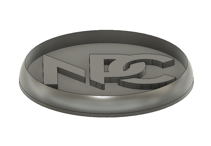

The design of the build should be simple, storable, and effective. It should not be so large that the seal is bigger than the cookie itself, and the imprint of the seal should not be overly engraved into the cookie. I considered two possible handle designs: one with a U-shape and the other, which I ultimately chose, featuring a spherical ball on top of an elongated cylinder.
Regardless of the handle style, both designs needed to have a circular base with the school’s seal extruding from it.
Step 5: Synthesizing

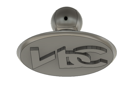

My plan is to create a vector image from the seal, import it into Fusion 360, and design a base layer to hold the extruded seal. I’ll also add a spherical ball handle to allow for adjustable pressing force. After this, you need to export your newly created cookie cutter/press as an STL file to place it into the MakerBot program. 3D printing makes the design storable and reusable, and if the press breaks, you can always reprint it for continued use. I placed my MakerBot print settings above as well.
Note how I positioned the cookie cutter's seal (the 3D model with the sharp lip on the edges) compared to the cookie press's seal. The cookie cutter seal is not correctly mirrored, which will cause the imprint to read "CPN" instead of the intended design. In contrast, the cookie press's seal is properly mirrored for the desired outcome.
