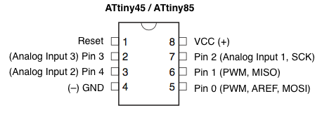

I have used Attiny85 microcontroller. It has vey few pin to connect with multiple devices and I had three devices(Temp sensor, Oled, RTC).
So I have used Tinkercad to first design the circuits in circuit simulation. At end I have finalized following connection:
PIN 0 as data pin for RTC and Oled Display.
PIN 2 as clock pin for RTC and Oled Display.
PIN 4 as input for DHT11

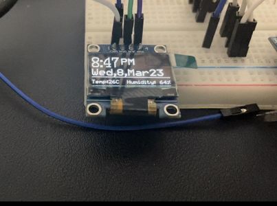

Setup Oled Display
Testing Display is always a fun eg trying different font,style. It also connected through I2C protocol, all device has there own id so you can connect it together.
Pin 0 for data,
Pin 2 for CLK
VCC and Gnd
I have used biggest font for displaying Time, medium for Date and smallest font for weather.
I would recommend your own style to display/place the content. I have used Tiny4kOLED library.

First need to Initialized oled,RTC and Dht sensor.
Then read the data from RTC and DHT and save in some variables.
Finally print the time date and weather data from above variables in serial manner in oled display .
