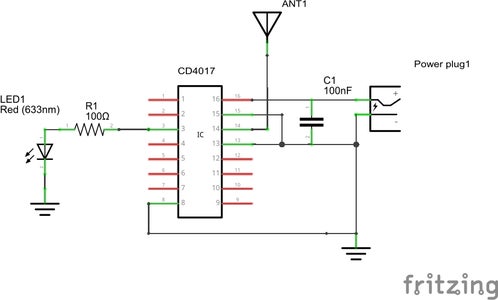

What you will need is :
1 CD4017 counter
1 100 ohms resistor (or bigger if voltage supply is over 5V)
1 0.1 uF capacitor (100 nF)
1 LED
1 small wire with insulation (a few inches)
1 battery (3.7V Li ion or higher)
The CD4017 is a dirt cheap circuit that takes a clock input and gives out a high logical level on one of ten outputs pins (0 first, then 1, ..., 9, 0, ...).
What the circuit does is really amazingly simple : plug a short wire (antenna) on the CD4017 input and it will interpret the Electric Field variations as a clock. This means that if you get close to a live wire, you will detect a 50 (or 60) Hz AC voltage that will be interpreted as a ... clock input by the very sensitive CD4017. This will trigger, in a rolling sequence, the 10 outputs and let you count the cycles.
The other cool idea (not mine again !!) is to use only one input, it means that you will see only one out of 10 "clock signals" : the LED will blink at one tenth of your mains frequency : 5 or 6 Hz, slow enough to be seen by the eye.
Depending on your DC source remember to add a current limiting resistor (rule of thumb : 100 ohms for 5 V, 390 ohms for 9 V).
