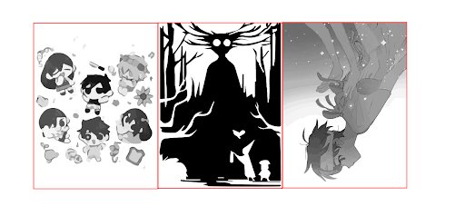

I used Adobe Illustrator to design the laser engraving for the acrylic sheet. My school provides an educational access to this software, so try to ask your school about it too! It is a powerful tool as well. (Here is a video that walks through the basics of using Illustrator)
To design it, I searched some images on Google and downloaded it. Then I placed it in Illustrator and used "Image Trace" (here is video 1 and video 2 explaining what it is and how to use it). Basically, it can be used to change a jpg image into a vector based design that makes it easier to edit the design.
Make sure the acrylic you are using is 0.13 inches thick!
Also, you must keep your design black and white, because that is how the laser will read your design. You can choose a colorful image and then use image trace to convert it to black and white.
Then, in order to tell the laser to cut through the material, you must draw out the shape you want to cut (I drew a rectangle in the image above) in red and the line width must be 0.001 inches.
Lastly, make sure you change the dimensions of your canvas to the size of your laser cutter so that you'll save yourself from pain and suffering later on.
Then, save it as pdf and upload it into the Universal Laser Systems (ULS)
