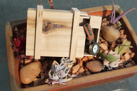

Introduction: Chinese Secret Box
This little box is really cool, because although fairly simple to make, it has a secret - nobody can find the opening! With the sliding tray obscured, it looks like it has no opening, and is sure to baffle almost anyone. This is a really fun gift, and perfect for stashing little trinkets in!

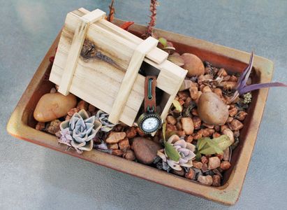

Step 4: Assembling the Inner Box/sliding Tray
Glue the sides to the bracing pieces and the end piece to the bracing pieces where they join.
Glue the other two bracing pieces to the sides and the bottom at the other end.
Glue the other end piece that fits the outer box to the inner drawer open end – ensure that it lines up with the bottom part of the drawer. At this point check that the inner drawer slides easily into the outer box. Sand the inner drawer to ensure that it does.
Step 5: Adding the Secret Panels
Glue the two pieces cut out from the top and bottom of the outer box in Step 2 to the inner box at the corners so that they fit into the cut-outs on the top and bottom of the outer box. These will be the secret opening panels, and allow you to slide the tray in and out of the outer box.
Step 6: Adding the Outer Frame Pieces
At 15mm from either end glue the bands around the outer box. While you can happily stop after the last step, this step ensures that the secret openings look hidden on the final box.
Your Chinese secret box is now complete!
