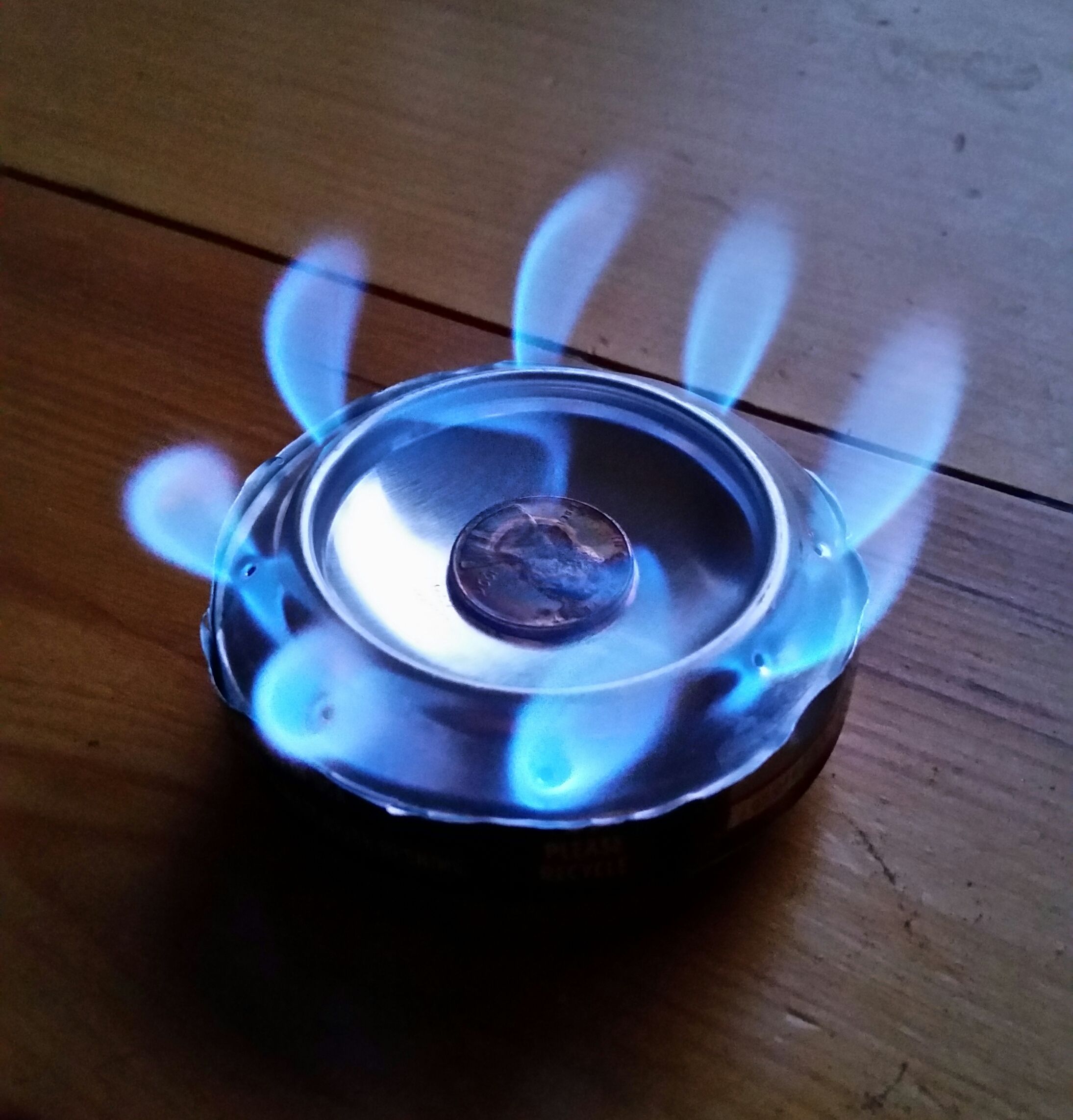

Because the halves are pressure fit, you'll need to poke holes in the top to let the air escape. It just so happens that we need a filler hole anyway, so use the thumbtack to create one in the center.
Now carefully align the halves so the top fits inside the lip of the bottom. You'll probably have to use a shim made of left over can pieces.
Once they are aligned, squeeze the halves together as tight as you can, making sure to keep them even.
If you're having problems getting the halves together, use the sandpaper on the inside of the bottom half to remove a little of the aluminum. It also helps to smooth the cut edges of both halves to allow them to slide together easier.
Step 5: Make the Jet Holes
Your stove will need some jets for the fuel to escape from and burn.
Use a thumbtack to poke a hole in a random spot around the edge of the can, make one directly across from it, then another in the middle of those two. Continue in this fashion until you have about 16 jet holes.
If you want a more efficient stove, use a medium sized needle for the holes instead of the thumbtack, and make more holes.

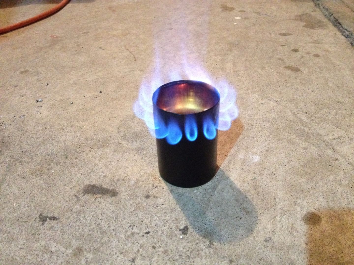

That's it! The can stove is complete. Now it's time to test it out.
First, slowly fill the stove with Heet, allowing time for it to drip inside. It only takes about three tablespoons to boil a pot of water.
Once the fuel is inside, it's ready to light. Use a match or lighter under the bottom to preheat the stove. It only takes a few seconds. Once the can stove is too hot to hold, preheating is done.
Quickly run the lighter or match over the jet holes to ignite the alcohol fumes that should be coming out now. Alcohol burns very clean, so the flames will be hard to see in daylight.
Place the pot stand over the stove, and cook up some food!
You can blow out the flames if you need to, otherwise it will burn itself out. If you used fiberglass or cotton balls inside, there's no need to dump the excess fuel before storage.
You can use some tin foil around 90% of the bottom of the pan to create a wind shield that will also assist in keeping the heat on the bottom of your pan.

NiKiToS
NiKiToS
9 years ago on Step 7
thanks, great instructable. Just a couple of questions:
1) I've seen in other instructions (don't think on instructables though) that you need to cover the filling holes with something like a penny, is that really necessary?
2) Maybe somebody knows, is there an equivalent for HEET in Germany?

Reply 9 years ago on Introduction
And to answer your first question: It prevents (somewhat) the burning trough the big filling-hole.
If you have one big hile, most of the pressure and thus vapor will exit there and you have one big flame coming out of your filling hole. But we want many evenly spaced flames on the rim, right? So block the filling-hole with something (Penny, Screw, Plug, Insulation, ...) and let the pressure exit the outer holes and generate a neat ring of fire.
