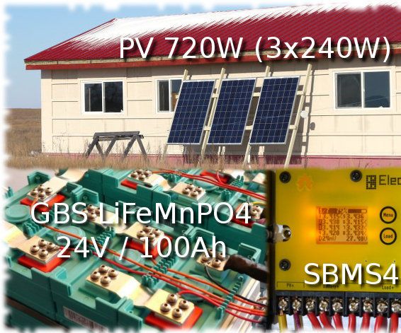

For my Solar BMS project I needed 3 PCB's
one for the power components that is a metal core PCB is similar with a normal FR4 PCB but is a single layer and is made out of 2.5mm Aluminium plate (2.5mm is for my particular case can be less) then about 100um (0.1mm) Teflon layer for electrical insulation but with excellent thermal conductivity then there is that 1 layer of coper and of course solder mask and the other things that you want :).
So this metal core PCB (the one with black solder mask) is at the bottom then there are two layers of spacers 1.6mm then there is the main board with all the small non power components I call that the main board then another two layers of spacers that are exactly the same as the ones before and then the last PCB that is the front panel has the cut out of the LCD and capacitive buttons.

And here is the final product attached to a heatsink for increased power dissipation. In this case since the device is high power 40A charging simultaneously with 80A discharging possible the TDP is around 20W and the small metal core PCB can dissipate at most 5W without active cooling or as in this case larger passive cooling.
