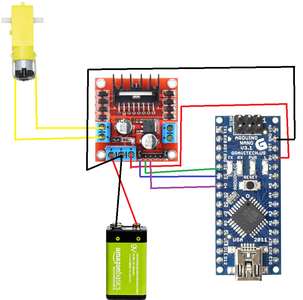

Step 4: Wiring Diagram 1 - TT Motor

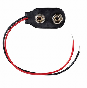

This is a wiring diagram 1 (for motor driver l298n). The second picture shows the battery clip, which is used to connect the 9v battery.

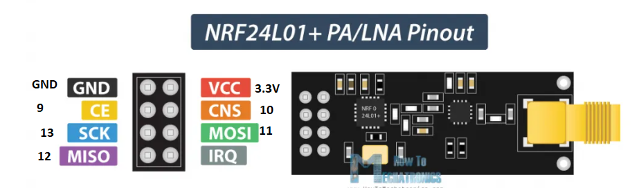

Step 5: Wiring Diagram 2 - the Receiver
In this picture, you can see the pinout of the nRF24L01 Module and Arduino pins in black.

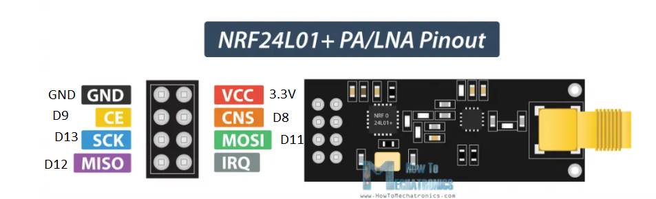

Step 7: Wiring Diagram 3 - Transmitter
Attach the Funduino joystick shield to the Arduino Uno and connect the nRF24L01 Module as shown in the picture (Arduino Pins in black).
