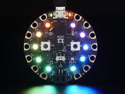

all 10 CPX led will be in red if you have uncompleted tasks and green if the table is empty.

1."CPX", or in other words - "adafruit circuit playground express".

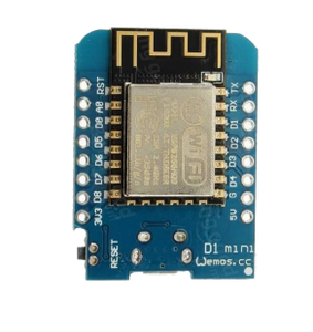

3. ESP8266 connects to the CPX with the internet.

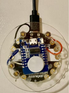

1.conect the ESP8266 to CPX:
  • ESP8266 "GNP" to CPX "GNP"
  • ESP8266 "VCC" to CPX "VCC"
  • ESP8266 "RX" to CPX "TX(A7)"
  • ESP8266 "TX" to CPX "RX(A6)"

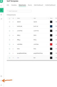

Step 2: Blynk
  • open your account and go to 'Templates'
  • click on "new Template"
  • in the opened window fill all necessary fields according to the picture above.
  • go to 'Search' and click "new Device" then choose your Template name and Device Name

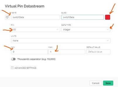

  • go back to 'Templates' -> tab "Datastreams
  • click "Edit" then choose "Digital" as New Datastream and fill all necessary fields according to the picture above
  • click save and apply

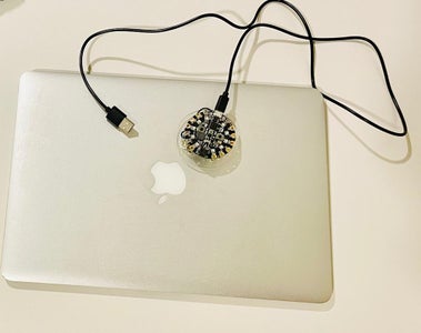

  • put your CPX next to your window near the light which comes through.

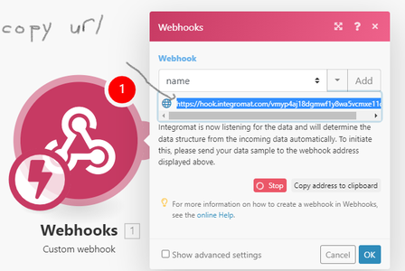

Integromat :
  • go to 'Scenarios'

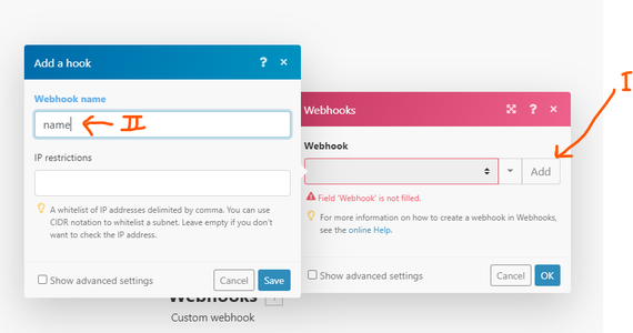

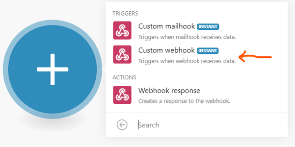

  • add "Webhooks" -> "add" -> give it a lovely name
  • click 'OK'

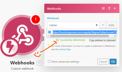

  • click the Webhook icon again copy the URL -> click on "Redetermind data structure" -> open new tab and in the HTTP URL filed right:"URL?value=a" ->you shuld see 'Accepted' in body page -> go back to the integromate scene and look for success message
  • go back to Blynk -> 'Settings' -> 'Developer: Webhook' -> in "WEBHOOK URL" field put the copyd URL from above. other field fill according to the picture above

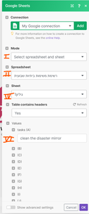

  • add "google sheets" -> "Add a Row" -> connect to yours Google account -> write the desire row
  • click on the connection and then 'filter'. copy the information in the picture above and instead "46800" (= 13:00 PM) write the timestemp right for you.(the all idea was CPX use light sensore so its importent to do the prosses once a day in the same hour)

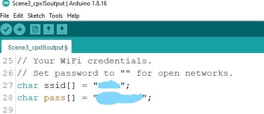

code:

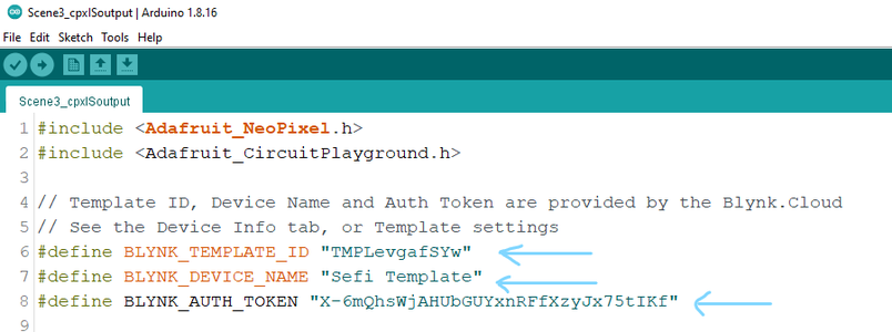

  • write all 3 fields from Blynk(see in the picture above) in every code file(Which are attached below) in the ight place
  • put in every code file yours wifi name and password
  • download it to your CPX

  • put your CPX next to open stove with clean plan on it , but not too close for safety..
Integromat :
  • go to 'Scenarios'
  • click 'OK'

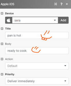

  • add "Apple iOS" / "Android" connect it to your device -> "Send a push notification"

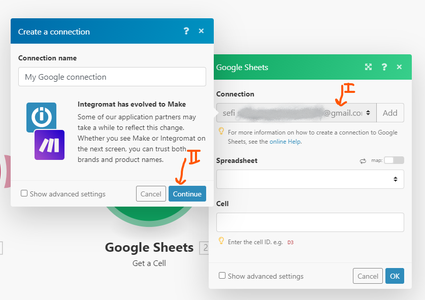

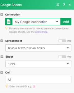

  • add "google sheets" -> "Get a Cell" -> connect to yours Google account

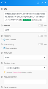

  • add "HTTP" -> "Make a request" -> go back to Blynk -> 'Search' -> 'you Tamplate' -> 'Device Info' -> copy the 'token' -> go back to integromate -> in the HTTP URL filed right: "https://sgp1.blynk.cloud/external/api/update?token=the 'token' you just copyd&V0={{if(1.value; 1; 0)}}"

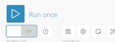

  • save the scenario torn the switch 'on' and click 'run'

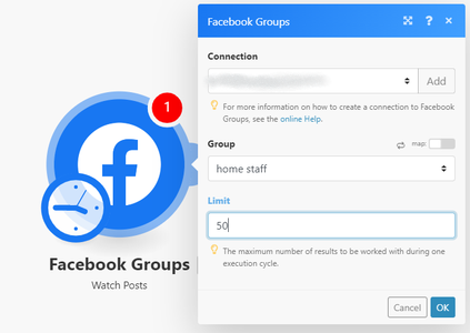

Step 6: Integromat-Scene4 + Code -facebook
Integromat :
  • go to 'Scenarios'

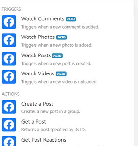

  • add "Facebook Groups" -> "Watch Posts" -> connect to yours Facebook account
  • get the Facebook group manger permission for using integromat

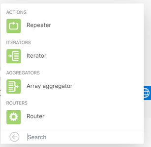

  • add "Flow Control" -> "Router" ->
I) add "Apple iOS" / "Android" connect it to your device -> "Send a push notification"
II)add "HTTP" -> "Make a request" -> go back to Blynk -> 'Search' -> 'you Tamplate' -> 'Device Info' -> copy the 'token' -> go back to integromate -> in the HTTP URL filed right:
"https://sgp1.blynk.cloud/external/api/update?token=the 'token' you just copyd&V0=1"
