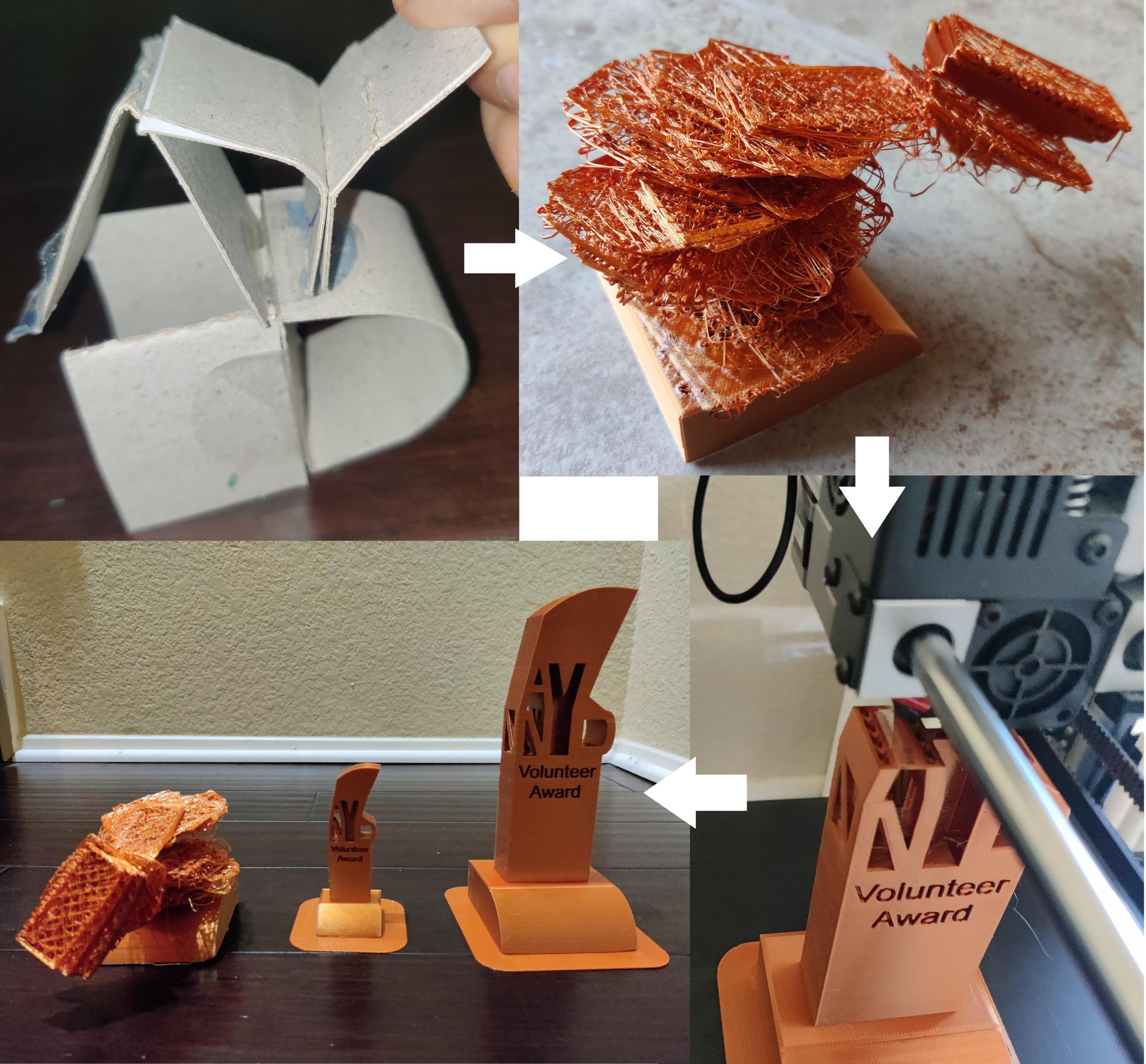

Step 1: Conceptualize With a Paper Sketch Model
The initial concept was sketched on a piece of paper.
Step 2: Create CAD Model Using Fusion 360
I used Fusion 360 as the CAD tool. The design history is captured in the video. Attached is the STL file.
Step 3: Experiment With Cura 3D Print Slicer Setting
Initial prints ran into issue with hard to remove support structure. The abundance of hollowed-out structure is a challenge to print. The support structure is hard to remove without also destroying the printed object. I experimented with slicer configurations for no support and significantly minimized support.

Full size build require approximately 13+hr printing time.
