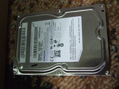

I got the new cheap Verbatim external USB HD 1TB for less then 90$ but it was so cheap Verbatim decided to leave out the fan so I had to improvise and add an external fan to keep the temperature down (it reached > 55C without the fan!

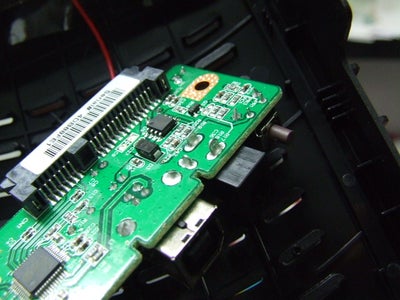

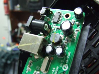

Step 1: The Internal Power Socket
Open the cage (warranty void) and locate the internal power socket.

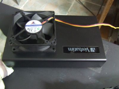

Step 2: Fan Selection
Try and find a low power fan about 7cm in size (they will make less noise) .

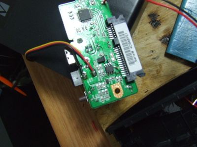

Step 3: Connect the Wires
Red to +12V and black to ground.

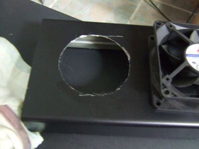

Step 4: Cut a Hole in the Case
Here I used a isolation tape to mark the size of the hole and then cut it out with a dremil (had to use 3 disks)

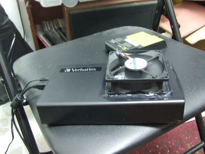

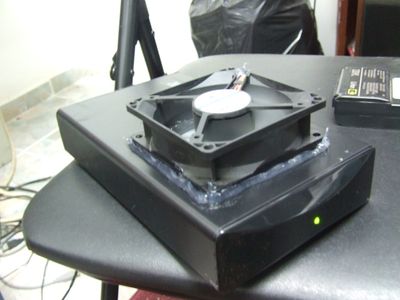

Step 5: Glue the Fan In
Use silicon .
Make sure you test it before letting the silicon dry (mine was touching the case so I lifted it us 2mm - problem solved)
Step 6: Final Product
Don't stick your fingers in (or add a mesh protector) .
I cant hear it and I don't feel any heat from it any more !
