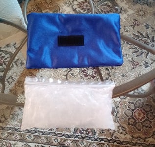

Just like the Cool Vest, you use the unactivated lining from adult diapers. Mix the lining with water and alcohol to create a gel that, when frozen, is slushy. Only this time put the gel into Snack-Size plastic baggies and put the baggies in the freezer. Double-bag the baggies to prevent leaking.
Step 2: Attaching the Cool Pack to the Hat.
Create a pouch for the Gel Pack out of the same material used for the vest (breathable, but somewhat waterproof) with a Velcro closure.
Add the "Hook" side of a Velcro patch to attach the pouch to the hat.
