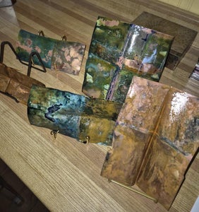

These are some of the final results please see photo in the first page the cover Photo but this is a very cool idea. If repeated please follow all the PPE and warning appropriate to this project!
We place these finished pieces on a metal stand brass etc.
