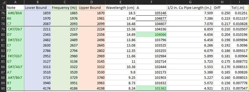

Now it is judgment time. How accurately can you cut your pipes? If you are like me and want each pipe to be not audibly out of tune, then the smallest pipes will require about 0.01" accuracy. Let's take a step back first.
Copper pipes resonate at a fixed frequency depending on their diameter, mass (density) and length. If you only use on kind of pipe (1/2 in.) you can vary the pitch by varying the length (shorter = higher frequency). But how do we know how long to cut each pipe?
We don't exactly. At least, it depends on a number of things that aren't easy to measure (temp, pressure, slight variations in the pipe) and compared to the tried and true, trial and error method, calculating everything would be a waste of time. That being said, there will be some calculating:
The frequency = a constant / (length ^2)
We don't know this constant and it changes slightly with different length of pipe so I found this method is best:
  • Cut pipe
  • Measure frequency (I suspended it on some rubber bands and hit it with a drumstick)
  • Use Audacity to analyze the waveform and find the peak frequency
  • Measure the length of pipe you have and with the frequency calculate the constant
  • Use that constant now to calculate the length (shorter) needed to be at the desired frequency (e.g. A7 = 3520Hz)
  • Compare the desired length to the current length and find how much needs to be removed
  • I found around 0.05" to 0.2" to be pretty accurate. Any more and it will be harder to hit the right frequency
  • Finally start over because you overshot it again and are running out of pipe (jokes)
  • Watch the attached video to see the frustrating find that one pipe had 2 different resonant frequencies depending on which way it was turned.
  • Repeat these steps until you have enough pipes
I also attached my calculation spreadsheet. You can use these lengths as references but yours will almost certainly be a bit different.
I used +-5 cents tolerances as humans can't really distinguish different frequencies in that region (+-5% the distance to the next note).
