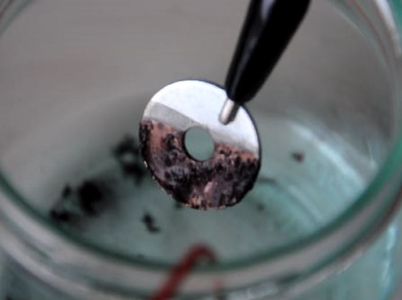

After 30min I unplug the power supply from the wall, I then remove the minus pole, or the copper peace that where bubbling before! I then place my metal object, or washer in this case in the alligator clip. Set your power supply as low as possible (to start with). The lowest my power supply could go where 3v. Connect you power supply back in the wall and watch your metal object be plated! I let my washer be in the liquid for 30min.
Some say that you need to let your copper plating dry for 1-2days before anything is done with your object. If this is true or not I do not know, still I have not seen any differences between removing the excess materiel directly or after 2days.
To get the plating shiny you can simply polish your object (then its required to have a polisher and polish for copper). Make sure to not polish to much sins it is only a thin layer of copper!
Do not forget to play around with the time and voltage to see the different results and try to get an even spread of copper over your object! :)
