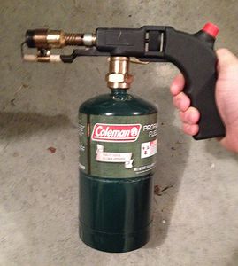

Step 1: Warning: Use of a Propane Torch
Just a quick warning before we begin. This tutorial involves the use of a handheld propane torch, which can be very dangerous if not used properly. If you are a younger creator/builder please refer this tutorial to an adult for supervision. Or consider using glue instead of soldering, which will work just a well. And please read the propane torch instructions carefully for safe operation, and wear proper clothing and safety glasses. Just want everyone to get through this tutorial safely and happily.

- Propane Torch and Propane Canister

In the first photo above, you will see an outer semi-transparent blue cone and a smaller light blue cone. When soldering you want the tip of the inner light blue cone to touch the solder joints. This is the hottest point of the flame. Slowly move the torch back and forth over all of the joints. After a couple of seconds, you will see the solder reflow, and the rings will begin to pull closer to each other. As soon as all of the joints are reflowed, turn the torch off and leave the piece undisturbed until the solder has time to cool and solidify. You can drip water on the joints to speed this up. Once cool, use a file to clean off any debris and excess solder. Repeat steps four and five to build the other door.

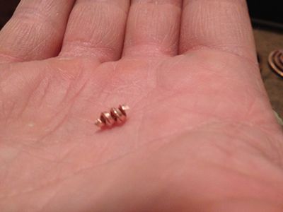

Step 7: Making the Hinge
The hinge is made up of two parts, a copper pin, with 90 degree bends on the ends, and a copper coil. Both can be made from that thin ring you cut earlier. Cut the ring on one side and use pliers to flatten it out. It doesn't need to be perfect, those little imperfections are what make pieces like this special. The coil can be made by twisting one side around a nail, holding in place with pliers, and twisting the other side around the nail. Clip the ends off of the coil and save the unused piece for the other part of the hinge.
Step 8: Soldering the Coil
Now if you thought the doors were difficult to set up and solder, than this could be a challenge. The coil and body will have to be fluxed, placed together with two pieces of solder, and held in place relatively snug while the solder is reflowed and cooled. I ended up using an old clamp I found laying around, which worked perfectly. It was only good for one time, but it did the trick. You can also try laying the body on its side against the coil. There may be better ways of doing this. So if you find a good way to do it, please leave a comment and pics for others to follow. I would appreciate it :3) Despite your best efforts, some solder may have reflowed into the coil, making it difficult to insert the pin. Use a drill with a bit, about the size of the coil hole, to clean the opening back out.
