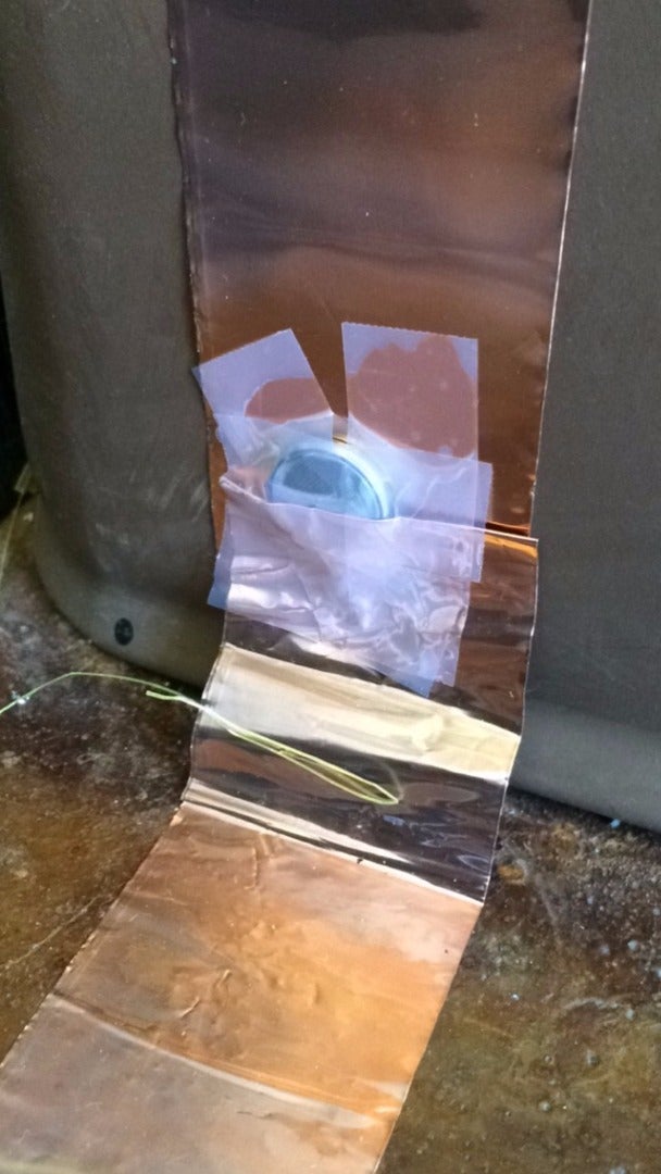

Step 3: Put Down Copper Tape
Peel off the backside of the tape so that the sticky part is exposed and place it how you've drawn it out in your design.
Step 4: Solder LEDs to Tape
Use the solder and soldering iron to solder the LEDs to the copper tape. Be sure to solder the positive and negative sides of the LED to the tape so that they will connect to the matching side of the battery. Make sure you have been instructed on how to use the soldering iron prior to doing this!
Step 5: Tape in Battery
You can't place the regular tape directly over the battery because it will cancel out the connection. Put the negative part of the copper tape onto the negative side of the battery, and same for the positive. Then tape the battery in once the copper tape is connected to it.

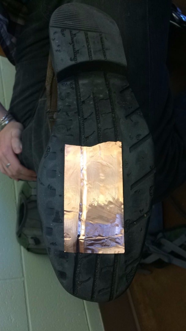

Step 6: Put Copper Tape on Shoe
Stick a piece of copper tape to your shoe or anywhere else you choose!
Step 7: Close Circuit!
After placing the copper tape on your shoe (or anywhere else!), step on the spot you left open to close the circuit. If your battery is fully charged and everything is connected properly, the LEDs will light up!
