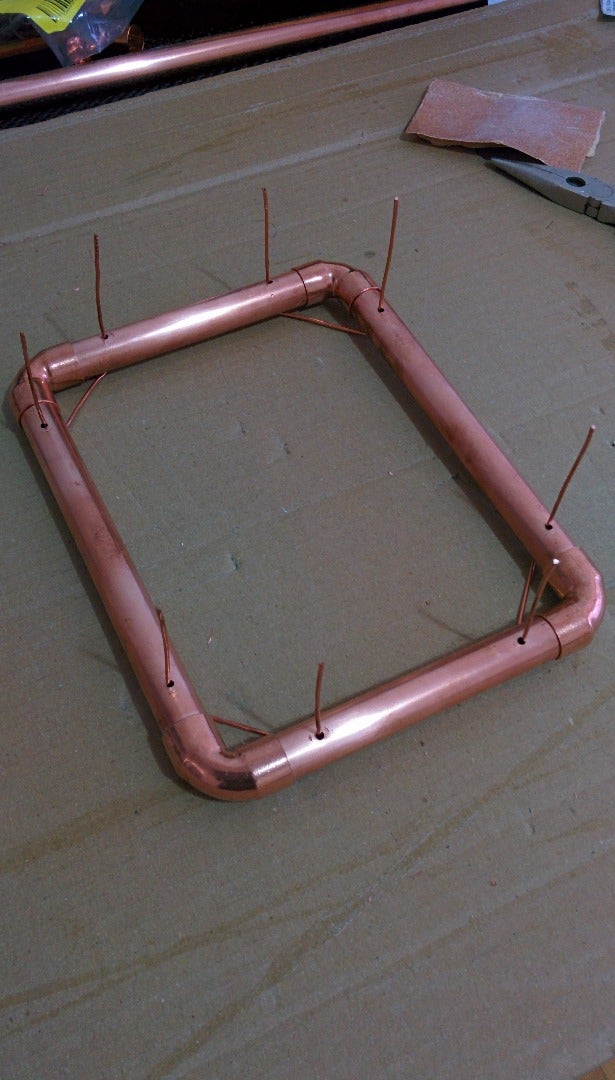

The individual frame is a pretty simple square made up of four pipe lengths and four 90 degree corners. The pipes all fit very snugly into the corners, and once everything is exactly how you want it then you just put a couple of drops of crazy glue inside the corner fitting, slide the pipe into it, and you're done. Note, though, that the glueing is only done at the very very end of the project, as you'll need to assemble and disassemble the frames a few times before you're done.
To see how long the pipe sections should be, just stick one into a corner fitting, line the photo up with that corner, and estimate where the next corner piece will go. Mark and cut the pipe at that location, put the corner piece on, and move on to the next side. Repeat. Just make sure the overall size is slightly larger than the photo itself.
One of the lessons I learned about pipe cutting is that if you're going to do a few of them (which you will), the pipe cutter will end up causing you blisters from all the tightening. You can avoid this by gripping the pipe with a set of lock grips (surround the pipe in a rag to avoid marking it) and then tighten the cutter with a pair of pliers.

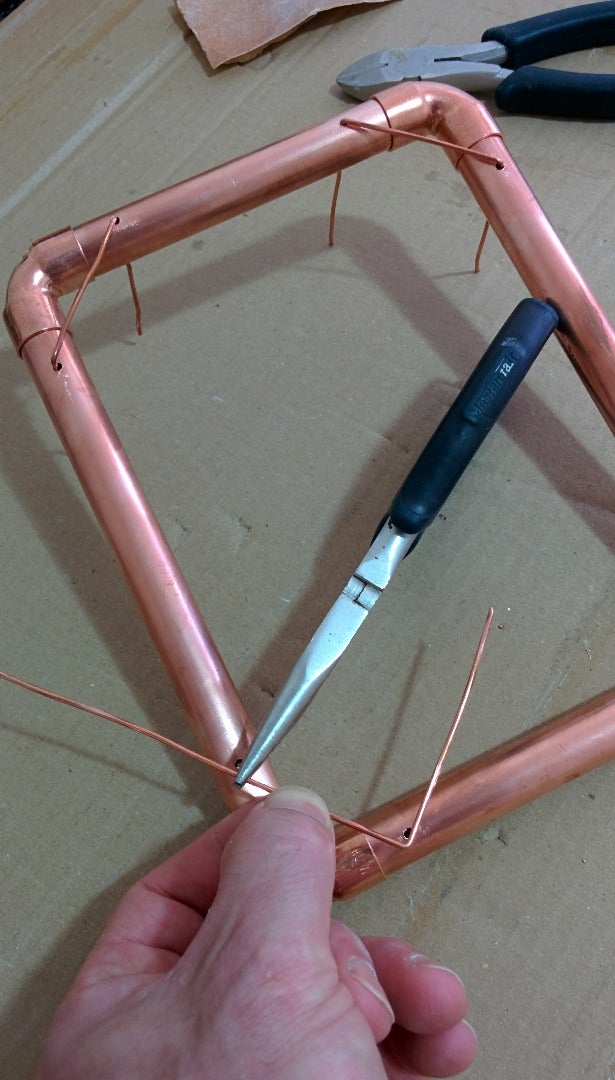

Once the frame is cut, it's time to worry about the mechanism for holding the picture in place. This is done by adding copper wiring to the corners. With the frame assembled (but not glued), make a mark about 1/2" away from the edges of the corner pieces on to both of the pipes that are protruding from it. Then, using a hammer and awl, hit those spots and make an indentation so you can later drill through without the drill bit dancing all over the pipe. Follow this by drilling a hole wide enough to accommodate the wire. The hole should go all the way through the back of the pipe.
When you have the holes done, file and sand them down, then bend a length of wire (about 8" in my case) into a square shaped "U" and fit it through both holes. The wire ends should be bent after passing through the back holes, and this is what will hold he picture and backing material in place.

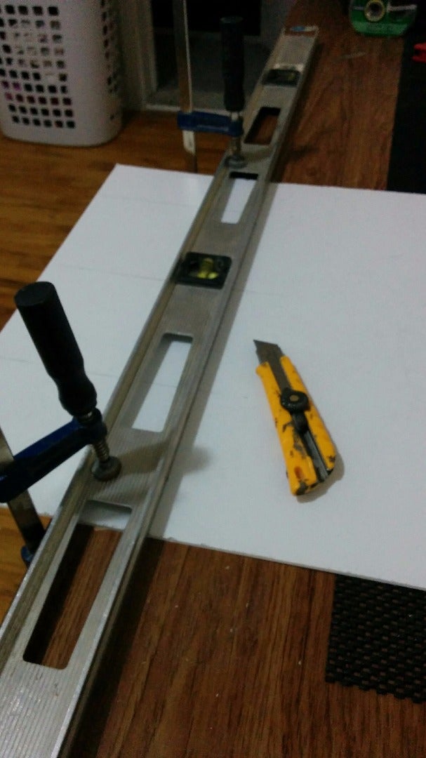

If you're buying the thin plexiglass (i.e. 0.25" thick), you can cut it with nothing more than scoring knife and straight edged tool like a level. Just mark your line, score it, and bend the plexiglass over the edge of a table. The sheets will break in two with a really clean line.
If you're using a thicker sheet (which for this sort of thing would probably be an overkill) then you'll need to use a jigsaw or circular saw.

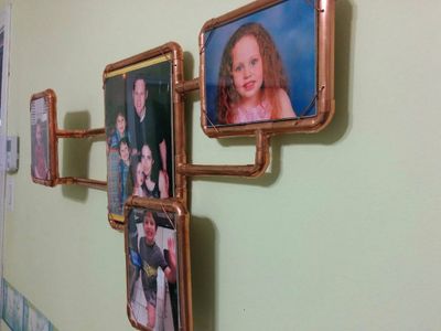

Now that the frames are fully assembled, you can start looking at the big picture and figuring out how you want them positioned and connected to each other. You can lay them side by side, you can overlap them, they can be assembled at different heights, etc. You really have a whole bunch of options.
When you've got a layout in mind, it's time to start fitting the extra corner and "T" connectors to hold all the frames in place. One thing to remember is that frames should be attached by at least two pipes, since their weight might end up causing them to sag (over time) and turn a bit if there's only one pipe holding them in place.
When all the pieces have been cut, everything fits and looks good, you're ready to glue it all up. Crazy glue will dry very quickly, so you'll have to be very methodical with your work. Have everything assembled, and then remove one connection at a time, put a drop of glue in, and quickly reassemble it.
I glued up the individual frames first, and then glued the pipes connecting them. Note that when you're glueing the frames you're probably going to move them around a lot. Make sure you keep the holes in the pipes properly aligned, and it's a good idea to work on a clean hard surface so you can always ensure the frame is kept nice and flat.
When everything is glued up, turn it around, add a couple of extra holes for the hanging wire, add the wire, and you're all done. Time to do a final clean-up with some polishing compound and add a protective layer of wax (I used regular car wax). Insert the plexiglass, photos, backing material, fold all the corner wires over the backing, and that's it!
