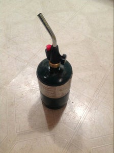

Zinc is a great metal for casting this project, so grab some pennies made after 1982. You will probably want about 10. Also get a torch, propane or otherwise, and cut a soup can down to about 1" of side wall. This will be your crucible.
Put the pennies in your crucible and hold the crucible with some long-handled pliers. Apply the torch to the pennies and don't by shy - zinc needs a fair bit of heat to melt with a torch. Once the pennies are molten, scrape off the copper shells with a screwdriver. The screwdriver should not be harmed in this process - any metal stuck to the head can be easily pried off.

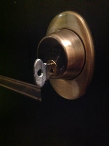

My key had some metal in the grooves, so that had to be removed as well. For minor cases of this issue, a triangle or square mini file works very well. For bigger cases, use a Dremel with an abrasive cutting wheel and keep your original key handy as a reference. I found that it was helpful to periodically test the key in the lock to gauge where I was at in terms of shape.
Once your key fits smoothly all the way into the lock, try turning it. If it works, you are done! If your key doesn't turn in the lock (like mine), then you probably didn't get the notches quite right. I found that watching this video and reading up on locks was helpful in understanding what was going on. Take your original key out again and closely compare it to your copy by placing them on top of each other. Are there any teeth that are too large? Is there metal in a place that it shouldn't be? Try a few minor modifications with a mini file and test the key in the lock again. Mine worked after two touch-ups.
After your key is done, drill a keyring hole in the handle and smooth any rough edges on the handle with some sandpaper. Brush it lightly with a wire brush and then wash any grime off. Then, admire your handiwork!
Just to prove that this actually works, I made a spy-movie themed clip on a dark night of me testing the key in my lock. As you can see, I try the door beforehand and it is deadbolted, so the door wasn't unlocked the whole time. :)
