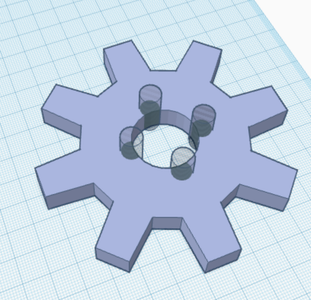

Tinkercad is an excellent software for designing objects for 3D printing. It's user-friendly and packed with features that help bring your design ideas to life! Fortunately, the shape of this charger wrapper is available as a pre-made option in Tinkercad. Simply find the "Design Starters" tab and scroll until you locate the shape shown in the picture above. Adjust the dimensions to suit your needs; I chose to keep mine at 100 mm by 100 mm, as I wanted it to be compact and capable of holding around two cords at once. If you prefer a larger size, feel free to make it bigger!

To create the holes, I selected a cylinder from the "Basic Shapes" tab. I increased the height of the cylinder and set its dimensions to 8.0 x 8.0 mm. Then, I duplicated it three more times to have four cylinders of the same size. I positioned the cylinders equidistantly within the inner circle of the object, ensuring that about three-quarters of each cylinder extended inside, leaving one-quarter hanging outside. Next, I selected each cylinder one at a time and clicked the "Hole" option. This converts each cylinder into a hole, creating indentations in the object where they are positioned.

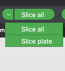

Now that you have your design made and downloaded it to your computer, we have to put it onto a platform that can relay all of the information to the 3D printer. This software is called Bambu. After opening Bambu, select "create new design." Now you will see a blank slate with a bunch of options and tabs around. Select the cube with the plus sign at the top left of your screen, and find the STL file you just downloaded to your computer. When you find the file, open it and you will see your design appear on the screen.
Next, you will select "slice all" at the top right and then "export all sliced file." After you have selected "export all sliced file"
