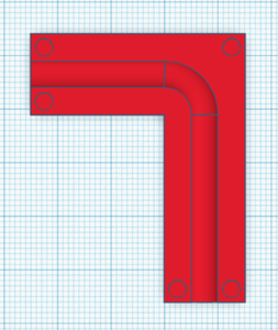

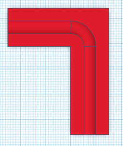

The Cordcaptor consists of four pieces in total, two of which are for protecting the side of the cable nearest to the phone and the other two are for the side nearest the charging head. Let us first model the two protecting the side nearest to the phone.
Cordcaptor - Top End

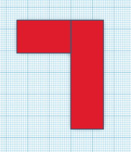

First, you must model the L-shape using rectangular prisms. The longer segment is 50 mm x 15 mm x 5 mm (l x w x h), and the shorter segment attached to its end is 15 mm x 25 mm x 5 mm. Group the two shapes together.
Then, we must make holes for the wire to go through. Create two cylindrical holes (32 sides, diameter 5 mm, and lengths 35 mm and 15 mm) then situate them parallel to the work plane. Make them 2.5 mm above the work plane and place the longer cylinder at the center width of the longer rectangular prism and vice versa. Group the L-shaped structure and the cylinders together.
To connect the cylindrical holes together, use a donut slice in the shapes library, with radius 1 of 2.5 mm and radius 2 of 10 mm, then cut the both ends using a rectangular prism to ensure that the arc is perfectly 1/4ths of a circle (you may also check that the width and length are equal). Situate it 2.5 mm above the work plane as well, turn it into a hole, and put it in the appropriate place.
Finishing it off, create five cylindrical holes with diameter and height of 3.4 mm (magnets are 3 mm + 0.4 mm tolerance for the printer). Place these 0.75 mm away from the outer edges and make them 1.6 mm above the work plane. Group all elements together. Afterwards, duplicate the entire part and mirror it horizontally.

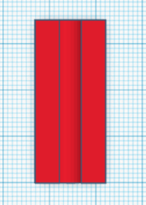

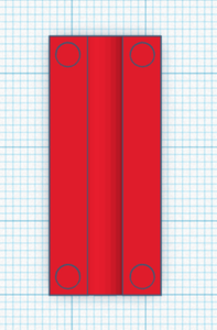

The bottom end of the Cordcaptor is much easier to model. First, create a rectangular prism with measurements 35 x 15 x 5 mm (l x w x h). Then, create a cylindrical hole (32 sides, diameter 5 mm, and length 35 mm) and situate it parallel to the work plane, 2.5 mm above. Place it at the center width of the rectangular prism and group the two elements together.
The final step is the same as the top end. Create four cylindrical holes with diameter and height of 3.4 mm and place these 0.75 mm away from the outer edges and make them 1.6 mm above the work plane. Afterwards, group all elements together and duplicate the entire part.
