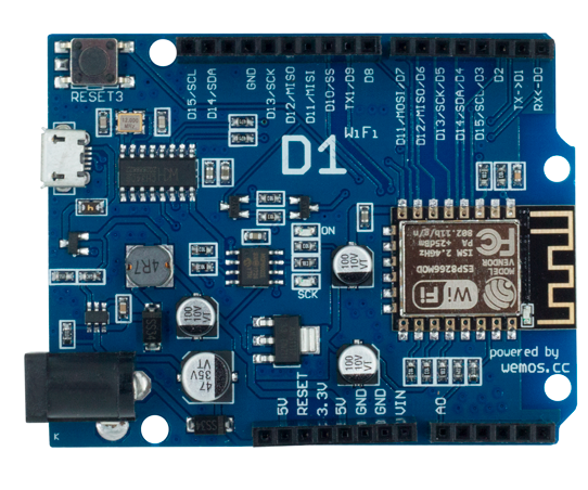

The necessary circuit will be built using an ESP8266 board and some leds. Here's what you'll need:
- board with ESP8266 microcontroller - the one used here is the Wemos D1 R1, a very inexpensive one
- 10 RGB WS2812 5050 leds compatible with the NeoPixel library
