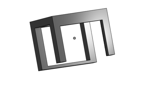

Step 2: Making the Base
The first step i did was make a 3.5in by 2inch C clip facing down, then i extruded it out by .35in. I did the same thing again and attached them together but closed the bottom on the backside. I then created a small platform on top for the mechanism.

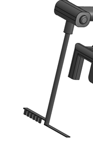

Step 5: Attaching the Mixing Bit.
Inside the housing for the motor, thread the hole for the mixing bit and clean the edges up for a clean fit. After you thread it, make some mixers for the scrambler by taking the thread diameter and copy those down and put it on the front of a long extrusion in the shape of a rake on one side by making a zig-zag pattern and removing it with the extrude tool. and on the other side, make a flat spatula type of blade close to the bottom of the piece. In addition, you can control how long you want the mixing bit to be based on your pot size.
