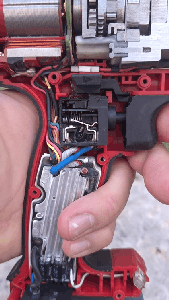

I left the PCB intact. I like the contrast between the gold coating on the green PCB and the rest of the drill.
Cutting different parts to different depths gives it an awesome 3D look.

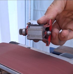

Step 4: Rotor Fail
Cutting the rotor was a challenge that ultimately failed. It's constructed of thin steel layers with strong neodymium magnets in between.
The steel layers warp and fall apart from the grinding wheel, the magnets melt and attract metal dust, making a mess, and the bearing is too small to be cut properly.
Luckily, since I destroyed only half, I flipped it around to hide the failure.

I cut away part of the trigger housing carefully to expose the mechanism inside while ensuring its structural integrity. It can still be pressed normally!
