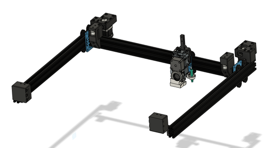

Step 5: XY Stage (CoreXY)
First mount the xy stepper motor mounts and xy idler mounts to the frame. Insert 2 25 Teeth (toothed idlers) into each xy idler mount. Slide the 25 Teeth pulleys onto the Nema17 xy steppers and mount them to the xy_stepper_mounts. Do not tighten the pulleys completely now, they may need to be adjusted after installing the belt.
Prepare the 3 motion plates. The plate for the x-carriage has to get 2 M4 holes tapped to later attach the belt clamp to it.
Slide the x-carriage onto the x-extrusion for the gantry. Then mount the two y-carriages on both sides using M5x12 button head screws. Loosen up 2 screws on each side of the x-axis to be able to install them in the frame. Make sure the gantry moves freely. Move it to front and back, left and right multiple times. If it binds up somewhere re-adjust the excentric nuts on the carriages. If this does not help, check if your frame is squre.
Add the XY_Joiners to the x-axis. The distance between the y-carriage-plate and the xy-joiner should be about 16mm. Insert the Idlers into the xy-Joiners. Each side should get 1 toothed idler and 1 smooth idler. On the left side the smooth idler goes in on the bottom, on the right side it is on the top.
Route through the GT2 10mm belts. Attach them to the x belt clamp with loose tension (yeah...tight but not to tight). For final belt tensioning we will use the slots in the stepper motor mounts. Mount the belt clamp to the x-carriage using 2 M4x10 countersunk screws.
Add 4 theaded inserts into the x-carraige dragchain mount. Mount the x-dragchain mount to the x-carriage using 2 M3x16 screws. You may install the dragchain now as well.
