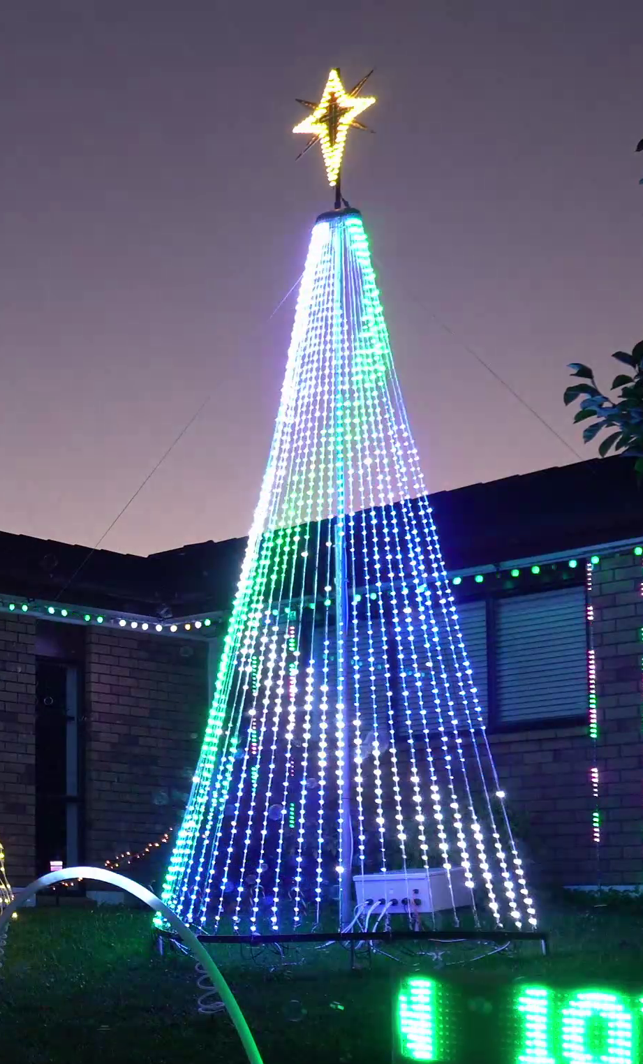

This is my addressable RGB pixel star I made in 2022 for my Christmas tree.
Design created on a computer, printed onto 5mm Corflute plastic and WS2812 5v Seed pixels added.

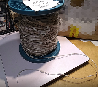

  2. Lights - I used WS2812 5v Seed pixel lights. You could also use regular seed lights.

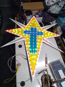

With some paper overtop of the printed corflute, I drafted locations for each of the seed pixel lights to be placed and a boarder to cut out.
You could also create marking locations in the computer design for more accuracy.
I used a sharp punch before cutting out in the next step.
Step 3: Cutting Out the Corflute
I suggest cutting out the design before mounting lights into place.
Lay out the corflute flat onto a cutting mat, or scrap wood, and carefully use a craft knife to cut it out. Using a ruler is a great idea to cut straight lines.
TIP: Cut in multiple light passes. This gives a cleaner quality cut to the corflute.
Step 4: Mounting the Seed Lights
I mounted these seed pixels by punching a hole through the corflute and pushing the excess wire between two lights through the hole. Fiction fit to hold into place. Glue can be used on the backside if needed.
But beware.... using a flat head screw driver is a bad idea. This can pierce the wire insulation!
These particular 'Seed pixel' lights can be purchased from AliExpress, Wally's Lights (USA), and a few other vendors.
Reputable vendors from China in my experience are: Ray Wu/Rita-lighting, ETOP Lighting, HarrisonTek KL lighting Store, GFLAI. Some of the Chinese vendors call these 'pebble pixels', beware that an actual pebble pixel is much larger and commonly do no use WS281x protocol.
